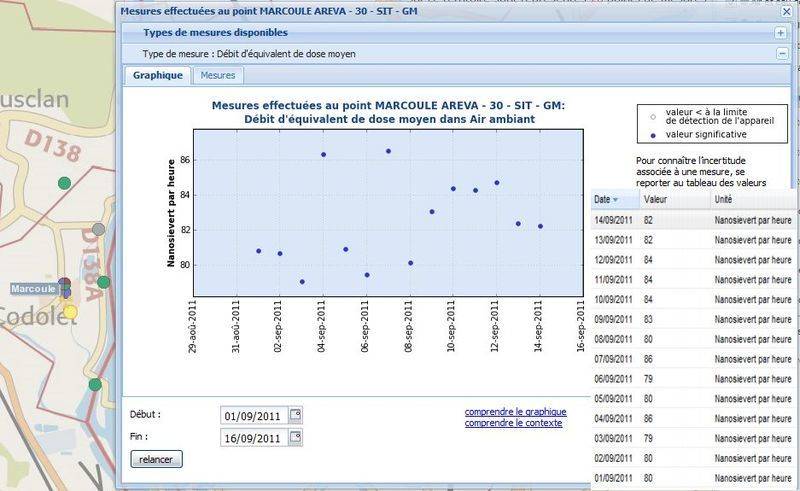

Here are the monitoring data for the past few days :
Source: http://sws.irsn.fr/sws/mesure/index
And today's screenshot of http://www.irsn.fr/FR/Documents/france.htm

80 nSv/h is 0.7 mSv/year, slightly below natural background levels (assuming they average at about 3 mSv/year).

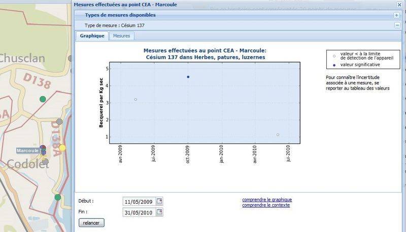

Some updates:
source: http://sws.irsn.fr/sws/mesure/index
Back in 2009 they found 4.5 Bq/kg of Cs-137 in grass:
http://www.ledauphine.com/vaucluse/2011/09/14/le-corps-evacue-le-four-expertise According to witnesses, the worker who died used a spud bar.
http://www.ledauphine.com/vaucluse/2011/09/14/une-expert-de-la-fonderie-donne-un-panel-de-scenarios The journalists interviewed the secretary general of the "Foundry Technical Society" about what might have happened. When you restart a furnace after a temporary shutdown, most of the metal is still liquid, but a crust has been created. "breaking the crust at that time is delicate" and the "pressure cooker effect" may occur. An other possible scenario is if the tool was humid. "water and melted metal can have such a reaction". A third possibility if if the worker needed to take the temperature with a pyrometer, which requires breaking the crust. Or without using a pyrometer, to find the temperature by looking at the melted metal's color, which experimented workers are usually able to do.
http://www.ledauphine.com/vaucluse/2011/09/13/apres-le-drame-de Some of the local mayors are angry. More than 24 hours after the accident they have received no information whatsoever from the prefecture administration. It seems that although the emergency plans provide that mayors should be kept informed when a nuclear accident happens, this time no nuclear emergency plan was launched and there is no such provision in case a non nuclear event like this one happens. One mayor says he had a phone call from the prefecture saying there is no worry.

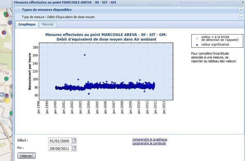

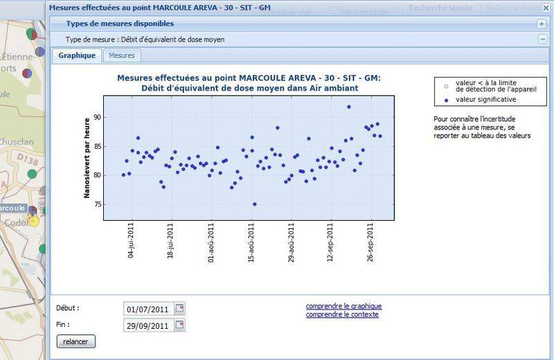

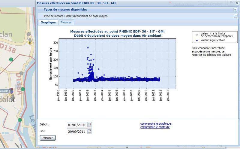

July-September 2011 trend
2000-2011 trend (apparently there was a peak in spring 2003)
2000-2011 trend further North at the Phenix EDF monitoring post (it looks like they had an even bigger problem in 2002)
There was what is believed to be a non-nuclear sodium-water explosion, without casualties, caused by heavy rainfalls, in the Phenix plant, Marcoule in September 2002 : http://www.asn.fr/index.php/S-informer/Actualites/2002/Incident-a-la-centrale-de-Phenix (not classified on the INES scale). There doesn't seem to be any nuclear event reported during those years.
