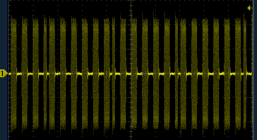

Allow me to try once more. My problem begins with a coded telemetry data stream at over a megabit per second.
A 50 MHz OSC is on off keyed by this data stream. This keyed output is passed through a BPF and on out to a load, let's call it 50 ohms for argument sake.
This is the signal I need to amplify up to ~ 200mW. A Class D power oscillator was used and employed a programmable switch-mode power supply to control the output level by varying the power supply to the Class D oscillator. That method of using a programmable switch-mode power supply causes other system issues and I'd like to remove that as the main control method for controlling the RF power output. I cannot change how the RF signal is created but I know darn well, there are many ways to amplify RF. What does it matter that my RF source happens to be modulated with a digital codded data stream?
What is the most efficient RF amplifier topology to use in order to amplify this RF signal I have, up to the 200mW I need?

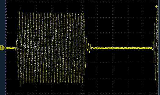

I still don't believe that the RF is turned completely off. I suspect it is AM. I have never heard of anything referred to as Amplitude Shift Keying. Can you see on a scope what this signal looks like after its filtered?
Looks like modulated RF with a peak at plus and minus 1 MHz around the carrier on a specan...
A CW signal would look similar on a spec an but it would be a lot noisier than AM. That is why I don't think it is CW. I don't think a class C amplifier will work for you. When you look at it on an OSCILLOSCOPE, not a spectrum analyzer, does the RF go to zero at any point or does the amplitude just get lower?
Let me run that test in the morning. I'll get back to you. And thanks for your patience and help!
Not sure if you have fully understood what CW (continuous wave) is. It SOUNDS like a carrier on all the time with no change. It is not. It is a carrier that is switched on and off like morse code. Generally not fast. Every time the carrier is turned off or on it generates extra noise in the spectrum around the carrier. Anyway, just thought I'd throw that in. I'll be waiting for your results.
Averagesupernova, As a one time ham, I know CW intimately. Attached are some screenshots from my RF source. The output is turned way down and I used a 100 MHz digital scope to capture these with the 50 ohm termination turned on. There is some proprietary info in here so the scales have been omitted on purpose, but trust me, this is ~50 MHz.

As a one time ham I am surprised you needed to ask this question. Looks to me like class C will work for you.
Hey! I was a kid! ;-) Now, trouble is, correct me if I'm wrong, but doesn't class C have bad efficiency? Maybe a class D with the switcher for the supply is better?
Sigh...
No, class C is the most efficient of RF amplifiers. Class D is NOT used at radio frequencies. I am not sure you understand what a class D amp does. A class D amplifier turns the output either full on or fully off so very little power is ever dissipated in the transistor. Suppose we have a switching frequency of 100 Khz and the duty cycle is varied and the output is low-pass filtered. If the duty cycle is varied at 100 Hz, a signal of 100 Hz comes out of the low pass filter. Class D can be used in switch mode power supplies, but you still need the RF amplifier in your case. The RF amp and the class D switcher are two separate parts.
