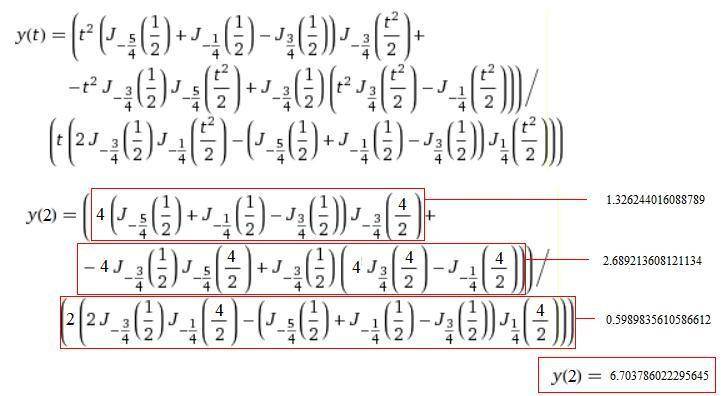

I found this initial value problem and was supposed to comment on the accuracy of Runge Kutta method. Please enlighten me on the analytic solution.
Find y(2) given the differential equation [itex]\frac{dy}{dx}[/itex]=y[itex]^{2}[/itex]+x[itex]^{2}[/itex] and the initial value y(1)=0.
Thank you.
Your equation has the form of a Riccati Equation. As per that wikipedia article, you can transform your particular equation into a linear second order ODE using the change of variables y = -u'(x)/u(x).

The question was initially meant to be an easy exercise. However I have been on it since without much success. With your suggestions I was able to do the following. However my result, on comparison with the Runge Kutta estimate, does not look good. I have limited knowledge on the operations on Bessel functions and could be making a mistake. I really want to know how to get around this.

As far as I can see with a quick look only, there are two main mistakes:
First :
BesselJ[-n,z] = (-1)^n BesselJ[n,z] is true only if n is an integer, which is not the case.
So, you have the choice :
Continue with BesselJ[1/4,z] AND BesselJ[-1/4,z]
or, if you want positive orders, use the relationship between BesselJ[-1/4,z] and BesselJ[3/4,z]and BesselJ[7/4,z], but it will be more complicated.
Anyways, in both cases, the two constants A and B must remain. You cannot eliminate one at this stage of the calculus.
Second :
At the end, it is not correct to add a new constant D, because -(df/dx)/f is not an integral.
Finally, you will obtain an expression y(x) with, into it, one parameter on the form C=(A/B), or C=(B/A), which can be determined according to y(1)=0.

Heres what I have done since (attached pdf). I know I shouldn't pursue it this long, but it is a good challenge. There are two possible solutions: a combination of Bessel J and Y, and a combination of Bessel J+ and J-. I worked them both out and if I didn't bungle it again, they neither match each other nor match the numerical solution.

I suggest that you first compare your result to the WolframAlpha results :
http://www.wolframalpha.com/input/?i=y'(t)=y^2+t^2,+y(1)=0
Best wishes !
The solution given by WolframAlpha leads to y(2)=6.703786022295645
which is in rather good agreement with the numerical result (Runge-Kutta process).
This make think that probably there are some mistakes in your analytical calculus.
Note that, if all was correct, the slope of the curves drawn on your graph should be equal to 1 at (x=1, y=0), which clearly is not the case for the blue curve.

It is not essential to reproduce the Wolfram solution. This was only to compare to the numerical results.
There is only one solution, but many manner to express it, with or without negative order for the Bessel functions.
The method that you used in your last pdf seems good. If you find where is the mistake, I am sure that all the curves on the drawing will be perfectly the same.
I have just checked the Excel worksheet. It truncates all non-integral Bessel functions so that [itex]J_{\frac{1}{4}}=J_{\frac{3}{4}}=J_0[/itex]. My bad. Sorry. Let me seek a different Besselcalculator. Thanks all.
Well, guys, I did get a good calculator and was able to use my two formulae for exact solution of the Ricatti equation to reach the same result as wolfram did i.e [itex]y\left(2\right)=6.70378602229564586367[/itex]. Great thanks to all of you. I was even able to come up with a graph that fits sufficiently well with the numerical solution. The site of the online calculator is:http://keisan.casio.com/has10/Free.cgi
