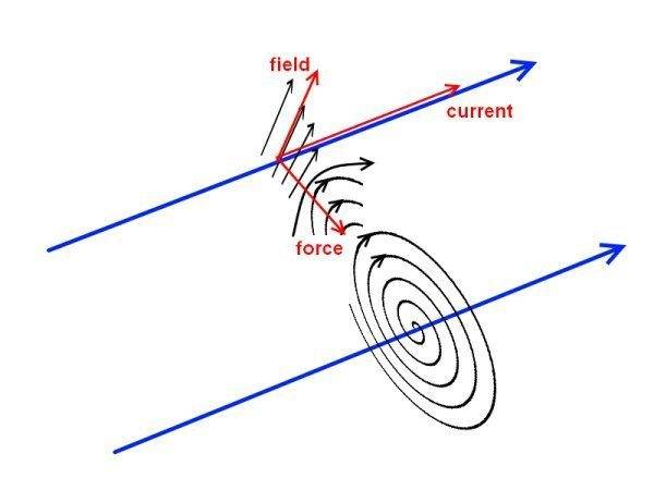

Could anyone have a look a look at my diagram I drew (amazing product of procrastination!), and just let me know if I have applied it correctly?
wow! long spring break! :biggrin:
yes that looks fine :smile:
(i assume your snaily spiral is just you being artistic, and you know that the field is really circles? :wink:)
Whooops. Thank you!

In your diagram you 'chose' one wire to provide the field and the other wire had the current so you apply IXB for the force. I'm saying that you get the same answer if you choose it the other way round. But this is just one way of looking at things. You can explain the force between current carrying wires without invoking magnetism at all.
