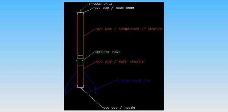

Ok, I've got it! Build a giant water rocket with spud gun technology. I can't believe that a physics teacher would actually allow a test like this. This is so dangerous. Does he not realize what aspiring engineers are capable of. Any how... Use a 1.5 ft long section of pvc pipe with a cap on one end of it. Naturally that can be picked up from the hardware store. In the center of the cap will be a shrader valve like the ones you use to put air in a tire. A tire shop should be able to sell one that is threaded and made of steel so that it can be bolted into position by non-tire shop employee types like us. That will be the nose cone and main body of your rocket. It will not carry any water. It will only carry compressed air.
At the end of the pvc pipe that doesn't have a cap on it (the bottom) attatch a sprinkler valve. These are electrically opened and closed. I know that you're not supposed to use electronic devices, but it may be a good idea for safety reasons. Since it can be opened and closed electricly, a remote device could be used to shut the valve if the rocket started to fly dangerously sideways. I'm not sure how to execute that in a frugal manner though. Just a though. The sprinkler valve is attatched with pipe cement.
On the bottom of the sprinkler valve, attatch another section of pvc pipe with pipe cement. This time make it about 1ft long. The bottom of this pipe will have a cap on it. This cap will have a small hole drilled in it. This section of pvc will hold water, and the small drill hole will be the nozzle. Actually, it might be best to cement a threaded female cap with a large hole cut in it to accept the sprinkler valve. Then various length threaded pipes could be used until the optimal volume of water is found. BTW, all pvc should be about 1.5" in diameter.
Make rocket fins out of balsa wood and glue them to the rocket.
Here you go. I didn't add any dimensions, but you get the idea.
The bowl-cage structure has most of the bowl sections removed so that you are left with only a frame resembling a bowl. I would think that the idea is all about stability. Placing the centre of thrust and center of gravity close together means that large torques will not be developed and therefore give it vertical stability (that is the structure remains upright - something that rockets are notorious for, which makes them dangerous[you've got a hard projectile with a lot of power endangering objects at ground level]). That plus the way the air flows over the bowl will also increase its vertical stability. The structure do tend to slip sideways if any wind are present, which will decrease the vertical height obtained (it is now spending its time moving along a diagonal).
