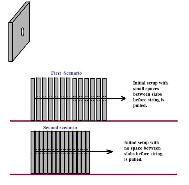

Suppose vertical slabs are placed on a frictionless horizontal surface as shown. All the slabs have a small hole through the center except the first slab on the left. A string is attached to the center of the first slab and the string is threaded through the holes in all the other slabs.
In the first scenario there is initially a small space between each slab. The string is then pulled to the right so that the first slab maintains a constant speed u. In this case, each slab attains a speed u before slamming into the next slab.
The second scenario has all the slabs in contact before the string is pulled.
In each case there will be a certain amount of work done to get all the slabs moving at speed u. The work required for the first scenario is approximately Mu2 while for the second scenario it is Mu2/2, where M is the total mass of all the slabs.
The reason for saying “approximately” Mu2 in the first case is that the work required to get the first slab moving is just mu2/2 while the work for each succeeding slab is mu2, where m is the mass of each slab. For a large number of slabs, the total work will be approximately Mu2.
The work is greater for the first scenario because internal energy is generated in the slabs due to the completely inelastic collisions.
The work-energy theorem stated in the form Wnet = ΔK is only applicable to a single point particle or to a system that can be treated as a single point particle. It is not generally true for a deformable system where parts of the system move relative to one another.

Yes, you are right about that. I made it reversible and elastic. So the KE in the chain is coming from the machine on the platform. Not the same. Ooops. Sorry.
  • #69
Oh please !
Why is everybody ignoring my previous posts in this thread. Please see my posts:20,21 and 48. I am just curious as to where I went wrong/or not. I (being a student) also did lot of such questions, but this one seem to bewilder me as well.
  • #70
sankalpmittal, the correct answer is not (D), F=ρ(u^2-gx). It makes no sense. Force decreases with increasing height? The force obviously must increase as x increases.
