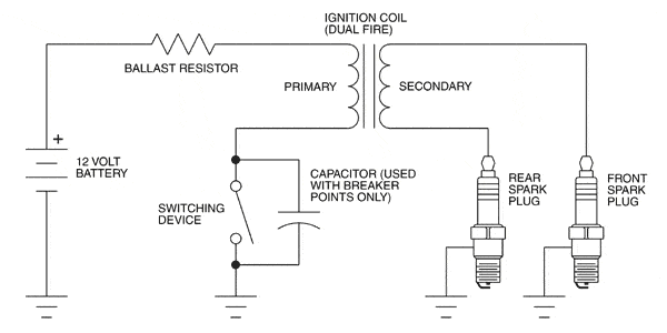

What really "sparked" (pun intended lol) my question is helping my brother troubleshoot a coil pack on his jeep that drives the high voltage needed for the spark plugs. I had never really looked at the schematic for the spark plugs used in cars in general, so I did a little googling and found the attached schematic.
In this schematic, it is a mutated formed of my original question: the primary inductor produces a back EMF when the switch is opened as predicted by Faraday's Law. This back EMF is "amplified" into the secondary, producing the high voltage needed to create the spark in the cylinder for combustion. However, without consulting the schematic, my intuition told me the two secondary conductors would be fed to each spark plug, as the high voltage would be produced in the "line-to-line" connection (if we can denote that in this context). However, I soon found out that it is customary for ONE coil to feed TWO spark plugs (almost like a phase to neutral connection in residential wiring), where one leg of the secondary line and the ground connection from the primary is fed to one spark plug (as seen in the attached schematic). However, the secondary doesn't appear to be grounded in this schematic.
If I try and visualize the flow of current during a "spark," current leaves the source feeding the primary, through the primary coil and back to the source. In the secondary, a second current leaves the secondary coil, but travels back to the primary side through the ground connection? This is what prompted me to ask if a ground fault current on the secondary of a transformer is "sunk" into the primary side...which appears as if that happens in the spark plug?

No, it's non trivial. I first encountered that spark scheme on a '49 Harley Davidson. Took me quite a while to believe it could work, yet the cycle ran fine.
Back to Kirchoff. And your schematic. Draw your two current loops, then try this talk-through.
Primary current gets interrupted by the opening of the points.
The capacitor prevents arcing at the points which is necessary if you want them to last more than about twenty minutes .
Flux decreases in proportion to current, and current collapses very quickly what with points open, so there's a fast decrease in flux.
Every turn that encircles that flux therefore sees a huge negative d[itex]\Phi[/itex]/dt .
So both coils experience an induced voltage, your "counter EMF".
The primary has not many turns so it sees modest voltage, like a few hundred volts. Touch that terminal on points if you don't believe me.
The secondary has copious turns and sees kilovolts. Enough kilovolts to jump two sparkplug gaps. As you know, don't touch that one it REALLY hurts.
So the manufacturer can save a coil by letting one coil serve two cylinders. Both get a spark once per revolution - but one of the cylinders is on exhaust stroke when there's nothing in it to burn.
Once again, the two current loops are independent. Draw them in two different colors and you'll see they do not mix.
When you see "misfire" code on your OBD reader, notice if you get it on two cylinders. If so check firing order - if the misfiring cylinders are one turn apart that's a strong indicator of coil trouble. They will swell up and crack with age and heat, then they're susceptible to water intrusion
