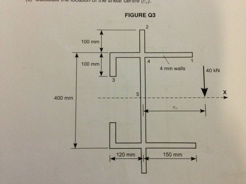

Could someone help me on how to calculate the second moment of area of the beam in the figure below?
Thank you
hi vtaela! :wink:
divide it into parts, and add the moment of area of each part
show us what you get :smile:
my calculations give me 172.8 *10^6 mm^4
is that correct?
thank you
vtaela: Excellent work. Your answer is correct.

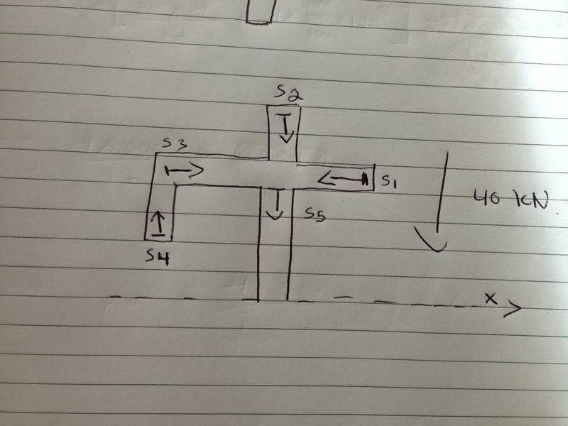

I am trying to find my local variables in order to calculate the shear flow! I have the local variables as shown below! Are my local variables set correct?
Thank you
Looks reasonable.
I finished with this, look similar to what you got?
Working out of ixx
Flow diagram and calculation of s1
Calc of s2, s3 and s6. The first picture i posted is calc for s4 and final value. Any idea how to do shear centre?
