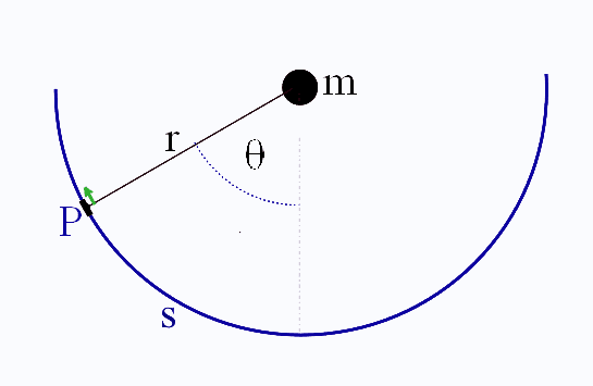

Consider the following setup (see illustration above): a mass m is connected to a circular section of a rail by means of a rod (with negligible mass) of length r, where r is the radius of the rail. The connection point P of the rod can move frictionless along the rail but is mounted such that the rod is always perpendicular to the rail, i.e. the mass is always at the center of the rail circle.
The rail is fixed to the ground and the mass subject to gravity. Initially, the rod is vertical (i.e. the weight of the mass fully supported by the rail). Now we push the rod along the rail until it is horizontal. The question is what work has to be done to do this? Let's see. The component of the gravitational force acting along the rail is given by
[tex]F(\theta) = m*g*sin(\theta)[/tex]
where [itex]\theta[/itex] is the angle from the vertical.
The work associated with moving the rod through an angle [itex]\pi/2[/itex] is then
[tex]W = \int F(s) ds = r*\int_0^\frac{\pi}{2} F(\theta) d\theta = m*g*r*\int_0^\frac{\pi}{2}sin(\theta) d\theta = m*g*r[/tex]
This means the work required to move the rod from the vertical to the horizontal corresponds to the work of lifting the mass trough a height difference r. However, the mass m has always stayed in the same location, so no work against gravity was done at all.
How is this paradox resolved?

If the system can remain in equilibrium for any value of ##\theta##, your force ##F(\theta)## must correspond to the static friction between the rod and the rail.
When you move the rod, you do work against the friction force. End of paradox.

What everyone in this thread is saying is that due to the position of the rod (BELOW the mass at the center), and the fact that the rod is massless, the rod is not producing any kind of force. This diagram at all points is equivalent to the mass at the center "floating" in midair.
you are fundamentally misunderstanding what it means for a force to act on a body :redface:
there are two forces acting on the mass:
i] its weight, mg vertically down
ii] the reaction force from the rod, mg vertically up​
these forces balance, and so the mass stays where it is
there are three forces acting on the rod:
i] its weight, which we can take to be zero
ii] the reaction force from the mass, mg vertically down
iii] the reaction force from the rail, acting radially​
these forces do not balance, and so the rod moves

It does seem weird. But there is no paradox. It seems weird because the rod is assumed to be very light, and also able to carry high tension (and stresses, when the rod is moved to be non-vertical). Intuitively in real life, if we see something which can carry large stresses, it is usually quite heavy as well. (except maybe spider silk).

Yes. For concreteness, let's assume that the structure consists of two pairs of frictionless ball bearings, each located an angle of ##\phi## away from the angle of the rod which is itself at an angle ##\theta## from the vertical. Then the forces at the bearings are:
##F_A=-mg \csc(2\phi) \sin(\theta-\phi)##
##F_B=mg \csc(2\phi) \sin(\theta+\phi)##
Each of these forces individually has no component tangent to the constraint, but because they are not parallel to each other, their sum cancels out both of the components of the gravitational force. Those forces are constraint forces and do not require any work, and neither oppose any external force attempting to rotate the rod.

I think that the confusion he has is not understanding that the system could be in equilibrium with no friction and non-zero ##\theta##.
If there is no elastic energy stored in the system and the rod is massless then the GPE of the mass does not change so no work can be done.
This is the sort of problem you get when you try to combine ideal components in a situation and then try to treat it as if it's non-ideal. There are a million such phoney paradoxes.

Constraints don't do work and don't have potential energy. In the scenario you posted there is only gravitational potential energy and kinetic energy, and both are constant. The constraint does not change either, nor does it add any additional energy.
Furthermore, the Lagrangian of your system is ##L=-mgh##, which is clearly symmetric wrt time. Therefore there is a conserved energy, per Noether's theorem.

I simply used Newton's 2nd law. Since the center of mass is not changing we have ##\Sigma F = m a = 0##. Breaking that up into components gives two equations which can be solved for the magnitudes of the two constraint forces. I can work it out step-by-step if you need.
Fantasist said:
2) Why do the equations for ##F_A## and ##F_B## have different signs, but in your drawing the vectors point essentially in the same direction?
As A.T. already mentioned, the illustrated direction merely establishes my convention that positive forces point inwards and negative forces point outwards. Note, that whether or not ##F_A## and ##F_B## actually point in nearly opposite directions also depends on ##\theta \pm \phi##.

  • #35
Fantasist said:
In order to neutralize the gravitational force [itex]m*g*sin(\theta)[/itex] tangential to the rail, it would take either friction or some obstacle ...
...or two radial forces at θ±ϕ which both have non-zero tangential components w.r.t to the radius at θ.
