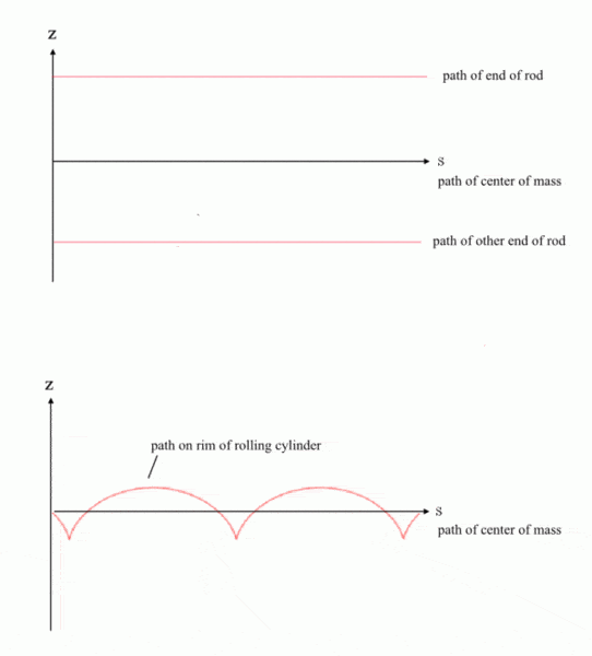

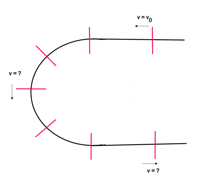

I have a classical mechanics problem related to the constrained motion of a mass:
as per the attached graphics, assume a thin rigid rod of length L and mass m moving frictionless constrained to a rail such that is always locally perpendicular to the latter. The rod starts off with speed v=v0 in the straight path of the rail. My question is, what is the speed in the apex of the curved section (half a circle with radius R), and what is the speed after it is in the straight section again? There are no external forces acting.
Thanks.

There must be an external force on the rod. ( A central reaction force from the rail acting inward on the thin rigid rod. )
A.T. said:
If it is frictionless and the rail is immobile then the velocity of the rod center is constant.
In the curve, the motion along the rail is not the only contribution to the motion - rotation will need some energy.
The velocity is lower, but goes back to the initial value once the rod leaves the curve - this is a result of energy conservation.
The force between rod and rail is internal.
You have ##KE=\frac{1}{2} m v^2 + \frac{1}{2} I \omega^2## during the curve. From that you can do a little algebra to get:
[tex]v=\frac{2\sqrt{3}R}{\sqrt{L^2+12 R^2}}v_0[/tex]

But the rod could only be slowed down and accelerated by a force along the rail (after all, the motion is essentially restricted to one degree of freedom). Where does this force come from?
Also, wouldn't the rod have to be slowed down and sped up instantaneously to the appropriate speed when it enters and leaves the curved section?

Yes, in the same way your rail needs "infinite forces" to start the rotation. A more realistic setup would have a curvature that increases gradually, then the forces and accelerations stay finite.

Surely, as the rod goes round the curve, its tangential velocity must be less than when along the straight. This allows the total KE (Rotational + Translational) to be unchanged. There will be a compression force on the rod as it enters the curve (slowing it down (gently - as the whole transitions onto the curve; there needs to be no step function in force, I think) and a tension, speeding it up on exit.
We needn't have friction if we don't want it and neither do we need any instant changes of anything.

Can you help me with this, please? How is the sudden application of the centripetal acceleration on the front of the rod any more problematic than a lossless bounce, which is usually treated as an impulse?
I assumed that this rod is just held on the track at a point at both ends. Is that right?
Maybe I'm missing something, but I see no impact and not much complexity in identifying the energy loss:
If the rod is held onto the track with pins at front and back, then when it enters the curve, one pin is on the curve and the other is not. The rotational acceleration is finite and the force applied by the curve is not perpendicular.
