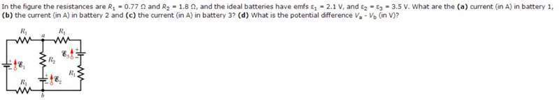

Circuit with multiple batteries finding the current through each one
In summary, by setting up equations using Kirchhoff's rules, you were able to find two different currents (Current 1 and Current 3) in the circuit. However, you were unable to solve for these currents due to the cancellation of the common factor Current 3-1. This may indicate that there is a mistake in your setup of equations, or that further simplification is necessary.
tmint
Diagram: http://gyazo.com/0b719e6d399ad894d2c48ce06d994672
In the figure the resistances are R1 = 0.77 Ω and R2 = 1.8 Ω, and the ideal batteries have emfs ε1 = 2.1 V, and ε2 = ε3 = 3.5 V. What are the (a) current (in A) in battery 1, (b) the current (in A) in battery 2 and (c) the current (in A) in battery 3? (d) What is the potential difference Va - Vb (in V)?
V=IR
Kirchoff's Loop Rules
Okay, for some reason I solved a part of this or two before and hoped to get back to it.
For part (a), I set up the equation of I being the current and R being the resistance; B being battery:
I= B2-B1/(4R1+R2)
And I got the answer .287A and then multiplied that by 2 and got the first part which is .587A. I understand the logic of its the potential difference divided by the equivalent resistance but why is that multiplied by 2, any reason for that? I didn't understand.
For parts (b)+ (c), I tried to set it up in a similar way but they are both wrong:
For part (b): B2-B1/(4R1+R2) and I got .287A
For part (c): I did the same equation as above putting in B3 instead of B2 and got .287APart (d) I was able to do by finding the potential difference between points (a) and (b) which I took the .287A value that I calculated in (b) and (c) and set it up like this:
ΔV=-I2R2^2+(3.5V) which comes out to 2.98V which was correct. I could use some help with this problem, I understand how the equation to solve B is found out, but I don't understand why you would have the EQ resistance to find the first battery, rather than the resistance the battery goes through. Could use a nice explanation on that. Thanks!
If someone could help with doing it the Kirchhoff rule way, I tried to assign currents with directions but for some reason I get something completely different from the correct answer I got in part (a).
I have a test on this material Tuesday and I REALLY need to do well, I blanked out on the first exam and forgot everything and did really, really bad :uhh:.
I really appreciate it! Thank you!

Hello tmint. Welcome to PF !
I get something different for I1, the current through battery 1.
Show what equations you get from Kirchhoff's Laws.
(Also, your notation is a bit confusing.)

Thank you.
Sorry for the notation I'll write it out to make it easier to follow. When I use Kirchhoff's rules I get the following equations:
Let c be left of a, d left of b, f right of b, and e right of a
Oh, and Current 1 is current from Battery 1, Current 2 from Battery 2 in the middle branch and so on.
Current 3= Current 1+ Current 2
cabdc: -.77(Current 1)+1.8(Current 2)- 3.5-.77(Current 1)+2.1=0
aefba: -.77(Current 3)-3.5-.77(Current 3)+3.5-1.8(Current 2)
I use the first equation and solve for Current 2 since Current 2 is apart of both equations.
Current 2= Current 3- Current 1
I then plug this into the above equations after I combine common factors and I get:
-1.54(Current 1)+1.8(Current 3- Current 1)=1.4
-1.54(Current 3)-1.8(Current 3- Current 1)=0
I get the Current 3-1 to cancel out, but I'm left with two different currents and I'm stuck. Any idea where I went wrong?

That all looks fine.
(By the way, you have chosen Current 3 to be opposite the direction shown in the figure. No problem however.)
You still have three equation in three unknowns but the last two are now in a convenient form.
Subtract the last two equations. (Bottom from top works nicely.)
What does that give for (Current3 - Current1) ?
Okay,
1.54[Current 3- Current 1]= 1.4
So [Current 3- Current 1]= 1.1 A
So would Current 2 by that equal 1.1 A?
Right?
Would I then sub this back in for Current 3- Current 1 and solve for Current 1 in the first equation or is that wrong?
Like so,
-1.54[Current 1]+ 1.8[1.1 A] = 1.4 and solve for Current 1?
Current 1 is .376A, that doesn't seem right? I solved this earlier, and really want to understand how its solved. Current 1 came out to .59A not sure exactly how though. My answer before fell within the 5 % tolerance
Did I go about it wrong?
Really appreciate your help.

Check your Algebra/Arithmetic .
1.8(Current 3- Current 1) - (-1.8(Current 3- Current 1) ) ≠ 0
Oh my mistake. So 3.6[Current 3-Current 1]=1.4
Oh you're right, this does work somewhat nicely.
So 3.6[Current 3- Current 1]=1.4
Current 3- Current 1= .389
So Current 2= .389 , I'm kind of suspicious of this value. Its differs from what I got previously. Did I mess up again in my arithmetic again?
and with that value you plug in that for the other ones right into the previous two equations to find Current 1 and Current 3, right?

3.6[Current 3- Current 1] is only part of what you get by subtracting those equations.
It's what you left off of the left hand side when you got
1.54[Current 3- Current 1]= 1.4 .​
Oh okay,
So 1.54(Current 3-Current 1)+3.6(Current 3-Current 1)=1.4
5.14(Current 3-Current 1)=1.4
5.14(Current 2)=1.4
Current 2= .27A!
And I take this value and plug it in back,
I get Current 1= -.593 A change the direction
and I get Current 3= -.323 A change the direction!
And solve for part D which is the EMF of battery 2- (Current 2 times Resistance 2) and I got 3.01 V
Thank you so much! Makes so much more sense now! A big problem of mine was the substituting and your steps helped clear that up. Thanks for not just giving me the solution and helping me figure it out.
