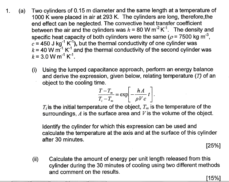

Problem is in attachment pic.

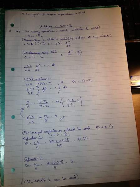

My attempt is on the pics 1 and 2.
Firstly, is it valid to assume length as 0.075m?
- For part (i), from the question it infers that one of the cylinders is applicable to the lumped capacitance method, for this Bi should be less than 0.1, although only cylinder is 0.15 which is the lowest. Bt I will assume that this is the one because the question asks to use the cylinder in which lumped capacitance works.
- In my working for part (i), I have calculated the temperature after 30mins, but the question asks for the temperature at the AXIS and at the SURFACE of the cylinder. So I am a little confused on how to go about with this
- For part (ii), is the way I calculated amount of energy per unit length released by cylinder in 30mins of cooling correct? Also it says there are two methods, has anyone got any idea on what the second method could be
Thanks alot!

I wasn't able to see very well what you had written, but it seemed that the first part looked OK.
The length of the cylinder is irrelevant in this problem. The characteristic length in this problem is either the radius or the diameter. If the characteristic length in your book's definition of the Biot number is the radius of the cylinder, then using 0.075m was correct to do. If the characteristic length in your book's definition was the diameter, then you should have used 0.15m. I don't have your book, so I don't know, but in many books, the radial temperature profile within a cylinder is given graphically as a function of dimensionless time at specific values of the Biot number.
Regarding which cylinder is the appropriate one for the lumped capacitance method to be valid, you have to ask yourself "in which cylinder would you expect the temperature profile to be more uniform?"

Chet, my man. Thanks a billion for all your input, it is very much appreciated. I did not reply for the past few days because I was still working on it. I finished my working, realized my mistakes and even got it verified by a phD student. I will show the correct working, so if anyone come across this thread they may use it.
Firstly, the biot number I calculated for both cylinders were incorrect because I was using the wrong value for the length. The L(c) is always Volume/Area. So if we use the equations for a cylinder: (pi*r^2*h)/2pi*r*h = r/2.
Now using a length of r/2 = 0.0375, for cylinder 1 I get a biot number of 0.075 (less than 0.1 which satisfies the lumped capacitance rule)
So in my initial thumbnail, showing my calculation of the temperature giving 519.6K (is correct) And since, it is lumped capacitance it is safe to assume that this the temperature at the surface and the axis. (so in reality, it was straight forward)
Now for part (ii), as shown in the second thumbnail of my working. For the first method, I used integration of the lumped capacitance equation to get a value of Q. Now after getting this, I simply divided the value of Q by the length, (3039/0.075) = 40524 J/m. Now the guy said its fine, bt I doubt it. Chet, can you verify that what I have done is acceptable.
For the second method of obtaining the energy per unit length, he said to use: Q = m c(p) (Ti - Tend)
I am assuming Ti = 1000K, Tend from part (i) = 519.6K. c(p) is given as 450. Now I am a bit confused about mass, how do I get that. Is this even correct, and he said after I get 'Q', simply divide it by the length (0.075m) to get the energy per unit length.

For the original problem, I get
[tex]\rho C_p (\frac{\pi D^2}{4})L\frac{dT}{dt}=-h\pi DL (T-T_∞)[/tex]
or, equivalently,
[tex]\frac{dT}{dt}=-\frac {4h}{\rho C_pD} (T-T_∞)[/tex]
Notice, the L's have canceled.
The solution to the above equation is:
[tex](T-T_∞)=(T_0-T_∞)e^{-\frac{4ht}{\rho C_pD}}[/tex]
At 1800 seconds (30 min), this equation predicts T = 520 K
Method 1 for getting the total heat removed per unit length:
[tex]\frac{dQ}{dt}=πDh(T-T_∞)=h(T_0-T_∞)e^{-\frac{4ht}{\rho C_pD}}[/tex]
Integrating from t = 0 to t = t, I get,
[tex]Q=\rho C_p (\frac{\pi D^2}{4})(T_0-T_∞)(1-e^{-\frac{4ht}{\rho C_pD}})[/tex]
Method 2 for getting the heat removed per unit length:
[tex]Q=\rho C_p (\frac{\pi D^2}{4})(T_0-T)[/tex]
Results from the two methods:
From both these equations, for t = 1800 sec (30 min), I get 28.6 million Joules heat removed per unit length
