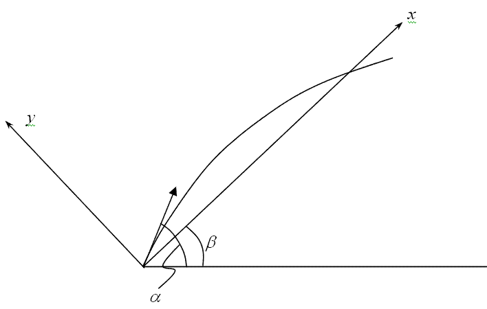

If a projectile is fired from the origin of the coordinate system with an initial velocity [tex] v_0 [/tex] and in a direction making an angle [tex] \alpha [/tex] with the horizontal, calculate the time required for the projectile to cross a line passing through the origin and making an angle [tex] \beta < \alpha [/tex] with the horizontal.

It's probably much easier if you take your [tex]+x[/tex] axis along the line through the origin inclined to the horizontal at the given angle [tex]\beta[/tex] and the [tex]+y[/tex] axis perpendicular to it, like in the figure.
Then, we have the acceleration components:
[tex]a_x=-g\sin\beta,\quad a_y=-g\cos\beta[/tex]
and the initial velocity components:
[tex]v_{0x}=v_0\cos(\alpha-\beta),\quad v_{0y}=v_0\sin(\alpha-\beta)[/tex]
We require the time interval between the points where it crosses the x-axis. Obviously, it will be the same time during which the y coordinate returns to zero. Now the y coordinate of the particle
[tex]y=v_{0y}t+\dfrac{1}{2}a_yt^2[/tex]
So [tex]y=0[/tex] imply
[tex]v_{0y}t+\dfrac{1}{2}a_yt^2=0[/tex]
the roots of which are
[tex]t_1=0,\quad t_2=-\dfrac{2v_{0y}}{a_y}=-\dfrac{2v_0\sin(\alpha-\beta)}{-g\cos\beta}=\dfrac{2v_0\sin(\alpha-\beta)}{g\cos\beta}[/tex]
The required time is same as t2.
Hence, the answer: [tex]\boxed{\dfrac{2v_0\sin(\alpha-\beta)}{g\cos\beta}}[/tex]
