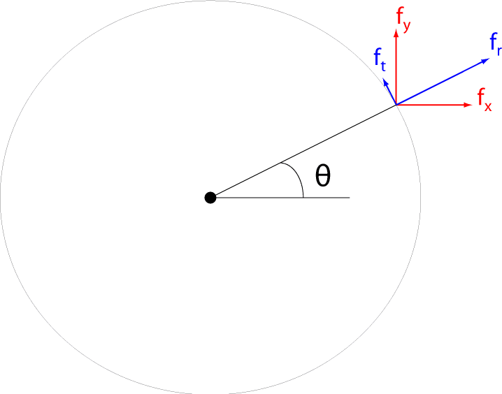

How would I go about the following:
A set of forces are pushing an object in a circle. These forces are recorded in the x and y direction in a 2D Cartesian coordinate system. I would like to convert the x and y force components to radial and tangential components.
Is this possible? If so, how?
All of the information I can find deals with using particle kinematics in such a conversion but I want a kinetic conversion.
Thanks!
Sorry if the above question seems like a homework problem or trivially possible/impossible. I study biomechanics and human motor control and and using the conversion to study central nervous system control strategies in handwriting. It's been awhile since I've looked at this sort of thing, so any help is much appreciated.
Say [tex]f_x[/tex] and [tex]f_y[/tex] are your force components in cartesian coordinates (along x and y respectively), [tex]f_r[/tex] is the radial component of the force and [tex]f_t[/tex] is the tangential component of the force. And say that [tex]\theta[/tex] is the angle of the line segment between the center of the circle and the point where the force is applied (see attached diagram). (the angle is measured from the X axis (horizontal))
Your problem consists simply in expressing your force vector in another reference frame, which can be done by multiplying it by a rotation matrix. Using the definitions given above (and in the diagram), you have the equations:

I hope this helps!
If you want to know more about rotation matrices, I suggest taking a look at Wolfram's page on the subject (mathworld.wolfram.com/RotationMatrix.html), which is presented in a more elegant fashion than its Wikipedia counterpart (en.wikipedia.org/wiki/Rotation_matrix).

Thanks. I was way over thinking it. I appreciate your help a lot!
