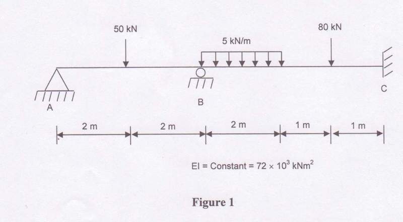

Question 2:
Figure 2 shows a continuous beam with two point loads and a distributed load. The weight of the beam is negligible by comparison. The foundations at supports A and B were not absolutely rigid and there was some deflection at these positions when the loading was applied.
Support A settled by 5mm and support B settled by 2mm
The flexural rigidity of the beam is 72MN/m^2
(a) Calculate the reactions at A, B and C, including the applied moment at C.
(b) Find the deflection at 50kN

For question 2, which is an advanced problem, it appears you ignored the given support settlements. Therefore, it appears your work on question 2 is currently irrelevant. Address the given question, and try it again. Question 3 is an advanced problem; list relevant equations and show your work. Question 4 appears slightly easier than questions 2 and 3; show your work for question 4.

can anyone tell me how to form the bending moment equation for question 2 if i turn the beam around? i mean if the built in side (c) is in right hand side then what is M(x) ? i was told that it will be easier if i do the problem turning the beam around. thanx

Problem 2 is a statically indeterminate problem, which I hope you have covered in your course. To solve this type of problems by classical means, we have to release the prescribed indeterminacies, in this case, it is to the second degree. For example, the pinned supports at both A and B can be removed, reducing the structure to a simple cantilever. The solutions to a simple cantilever is well known, well documented (for example, Strength of Materials by Den Hartog), and even easy to remember. Look up the reference and you will find that all you need to remember are the factors 1,2,2,3,6,8 for both displacements and rotations for moment, point and distributed loads. This reduces the problem to a determinate problem similar to problem 1. Apply a unit load Pa at A and find the deflections at A and B. Do the same for B. By solving a simultaneous equation of degree 2, you will find the values of Pa and Pb that reduce the deflections at both A and B to zero (or to the prescribed deflections in your problem). These are the respective reactions at A and B. Now by superimposing the given loadings, Pa and Pb on the RELEASED structure, you will get the moment diagram as you requested.
The above paragraph is essentially a quick course on statically indeterminate analysis of structures. I do not see an advantage having the fixed end at one end or the other, unless you described your proposed analysis strategy.

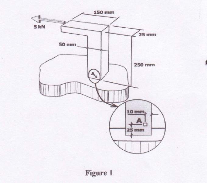

actually i got stuck with question number 5 now... can u give me a clue that what topics will i have to study to do it...?
I am not sure if I am missing anything. I see problems 1 to 4 in your initial post, and I do not seem to find problem 5 in your subsequent posts. Do you mean problem 4 or I missed something?
oooh its my mistake... I am sorry ... i didnt upload it by mistake...
Question 5:
The component shown on figure 5 is rigidly attached to a foundation. The cross section of the component is rectangular. A 5kN concentrated force is applied to the top surface of the component in the direction shown. Find out the stresses acting on the surface at position A and show them on an infinitesimal.

mathmate: What is the official name of the method you posted in post 16? Do you think the pin constraint at point A in question 2 is a typo by princes.fiona? I currently assume the pin constraint at point A in the second attachment is a typo, and should instead be a roller.
princes.fiona: Post your answers to question 2(a) and 2(b).
I have made the same assumptions as you did. In most building structures, the beam flexural stiffness is much greater than the supporting columns (in translation), so that configuration is equivalent to a roller joint as the axial movement effect is negligible in most cases.
