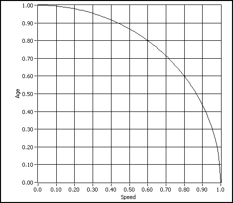

Instead of γ = dt/dτ, I like to think of dτ/dt = 1/γ, which applies to the tick rate of a moving clock with respect to the coordinate time of an inertial reference frame. The faster a clock moves, the slower it ticks.
From the SR definition perspective, completely agree. Is it the same thing as the description I have put?
No, it is not the same. You have stated that the Lorentz factor is the ratio of time passage rates between two observers. That is wrong.
Instead, it is the ratio of time passage rates between the coordinate time of an inertial reference frame and an observer (or a clock) that is moving in that frame. Even if you want to consider a second observer at rest in the frame, he cannot observe the Lorentz factor ratio between his own clock and that of the moving observer.
Your definition should obviously be incorrect to you because it is symmetrical, which only means that the ratio could not ever be anything other than 1. You have to at least make one of the observers different than the other one in order to have a ratio that is greater than 1. That difference is that one of the observers is at rest in an inertial reference frame in which times at distant locations have been synchronized to his clock. We imagine that there are many synchronized coordinate clocks throughout the reference frame at every possible location. Then, the moving observer is comparing the time passage rate of his clock to the time passage rate of whichever clock he is closest to as he is moving past these imaginary coordinate clocks. He finds that those clocks are ticking faster than his own but he's not comparing his one clock to just one other coordinate clock, he's comparing his one clock to many other coordinate clocks as they appear to be flying past him.

A very precise measuring system is available using reflected light. The light clock can serve as a standard unit of measure by reflecting light from a mirror to a detector.
In the U frame of reference, one unit of time is defined as the distance light moves from the origin to a mirror m located perpendicular to the x-axis and return. If the light source is not moving, the distance is 2d for 1 time unit.
Observer A moves a distance (a) while a light wave composed of multiple photons, moves from the origin a distance d. Because light speed c is constant and independent of the source, the A-clock photon must have an x component equal to (a) to compensate for A's motion. The p component becomes the active part of the A-clock. Since p is less than d, the photon will move a greater distance to reach m, resulting in a tick rate less than that for U.
The clock photon for B will have a greater compensating component b, and thus a smaller active component q, resulting in a tick rate less than that for A.
The tick rate is a non-linear function of (clock speed)/(light speed), or v/c, with each observer clocking a different photon. The observer is not aware of his slow clock rate, because all processes involving photon interaction, including biological/(chemical) are also ocurring at the same rate, i.e. his perception is altered. Gamma(the Lorentz factor) equals d/(the vertical component) with v/c substituted for (the x component)/d. Gamma for A = d/p with v/c substituted for a/d.
The 't' factor has been omitted, because it is common to each vaiable and d, and to emphasize that the clock is in fact counting distances.
https://www.physicsforums.com/attachments/52787
Your diagram and explanation are very difficult to follow.
You have established that for a stationary light source and observer, the light starts at 0, goes directly up to the mirror at m for a distance of d and then reflects back down for another distance of d for a round-trip distance of 2d. This part I understand.
This part I don't understand. You imply that the light only travels a distance d along the first diagonal but it doesn't reach m and you don't show the return path. You seem to be implying that length contraction is in play here which it is not so I'm very confused about your diagram and your explanation.
I've never heard of "compensating component" and "active component". Are these your terms?
I think what you have discovered is that if we plot the reciprocal of gamma as a function of normalized speed, we get a quarter of a circle. I made a similar plot some time ago to show the normalized age of the traveling twin (compared to the stationary twin) as a function of normalized speed (beta):
This was discussed in this thread, as well as others.
Although your plot might also describe the relationship of 1/gamma to speed, it is not labeled as such and has no discernable connection to a light clock, at least as far as I can understand. Maybe you could explain it some more and show how it relates to your diagram.

  • #33
This post is intended to explain gamma/(the Lorentz factor) in terms of physical
processes and minimal math instead of theoretical statements.
The light clock consists of an integrated light emitter/detector, and a mirror, separated
by a rod of length r. The clock counts a unit of time (t=1 tick) when a photon moves
the length of the rod to the mirror, and returns to the detector.
There are two observers, U who is not moving, and A who is moving at .6c relative to U
on the Ux axis. Each has a copy of the clock with the rod oriented perpendicular to the
x axis.
Since the outbound path equals the inbound path, we only need to consider the first
path.
With U and A at the origin, each clock emits multiple photons (shown as a blue quarter
circle because object motion is restricted to the +x axis.)
For U the photon moves a distance r (.5 tick).
For A the intersection of the circular arc and rod determine which photon becomes part
of the clock. [1]The photon path ct can be resolved into the vt component which
compensates for the motion of A and the st component which is the active part of the
clock. When a photon arrives at the U mirror, the A clock photon has not reached the
mirror because the photon speed relative to the rod is s. If r' equals the path length to
the mirror for the A photon, then t'/t = r'/r = c/s = gamma.
[1] A vector can be expressed in components suitable for the situation.
https://www.physicsforums.com/attachments/52882
  • #34
x axis.
path.
Like I said in my previous post #29, you have discovered a graphical relationship that relates speed to the reciprocal of gamma but it has nothing to do with your explanation of a light clock.
Your problem is that you claim that there is something significant when a photon hits the moving rod at the 80% mark. In fact, there are photons hitting both rods all along their trips to their respective mirrors. So what? There is no significance to the fact that a photon hits a rod at any particular time. What matters is when a photon hits the moving mirror, which you don't show. If you would continue the diagonal line up to the location of where the mirror would be when it hits it and then measure the time it takes for the photon to hit the mirror, you would see that it take 1.25 times as long as it takes for the photon to hit the stationary mirror which gives the correct illustration "in terms of physical processes".
  • #35
The hyperbola is the inverse function of the quarter circle, a fact of geometry.
The rod is only a visual aid to indicate a rigid device moving with A, and represents the photon path as imagined by A. It helps with those new to SR. The photon doesn't hit the rod. The successful photon has to have the correct angle to intercept the A mirror. How would it 'know' this? It doesn't. As stated, the successful photon has a horizontal vt component that equals the speed of the clock. The vertical st component moves toward the mirror but at less than c. The intersection of the arc of photons and the path/(rod) to the mirror is determined by the speed of A. The angle of the ct photon relative to vertical is a function of v/c. A simple examination shows, a lesser speed, a smaller angle and a greater s,
a greater speed, a greater angle and a lesser s.
The drawing is intended to show why 1 tick for the A clock is longer than 1 tick for the U clock for the general case, which it does. The reason is the constant and independent speed of light. The degree of dilation is a function of v/c. If the path is extended, it will not show anything new. Gamma is still the ratio c/s or (A time)/(U time).
