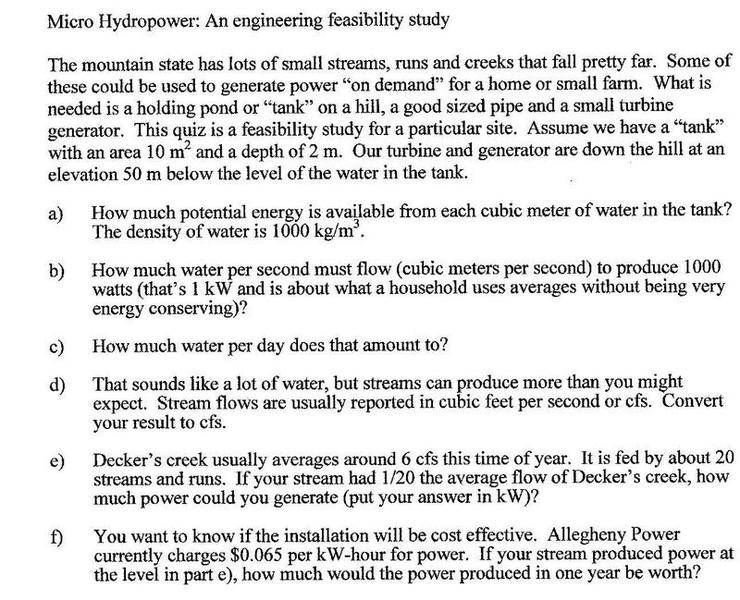

KE=(0.5)mv^2
PE=mgh
a.)
The tanks volume is 20m^3. I then multiply that by the density to get the mass of the water, which is 20,000 kg.
Apply that into PE=mgh for gravitational potention
(20,000)(9.8)(50)=9,800,000
-Is everything in the right units?-
b.) I have no idea how to do this part.
If I can get some help with part b, that would be greatly appreciated.
m3 = 1000 L
1 L = 1 kg H2O
20m3 = 20,000 kg times g and 50 m is your PE. So far so good.
But what does that give you? Joules?
And they want Watts? Which are what? Joules/sec?
Yeah, I got that far. What about part B though?
Your PE seems to be okay. As for b) what is the equation for power?
Edit: LowlyPion was faster...
Hm, I've been in class all day.
Power is Energy/time. I'm looking for the volume of water to produce 1000W
P=E/t, and I get 1000J of water per second for 1000 watts of power in one second.
Then I plug that into the GPE equation GPE=mgh where I'm looking for mass
1000=m(9.8)50
m=2.04kg
Then divide that by the density to get the cubic meters of water per second, .00204m^3
That number seems really small.
I'll attempt to solve the rest while waiting for a response to my answer for part b.
c.) 86,400 seconds in one day. 86,400 * .00204 = 176.256 m^3 per day.
d.) 1m^3=35.3ft^3
so .00204*35.3=.072cfs
e.) my theoretical creek would have 0.3 cfs
I'm not sure where to go from here
Part b looks ok at about 2.04 L/s
1 L = .0353 cf
OK to e) so figure what they want.
It takes 2.04 L a sec to generate what you need - i.e 1000 w.
If the flow of 6 is reduced to a 1/20 that makes it 6/20 cfs *1/.0353 cfs/L 8.5 L and then 1/2.04 kw/L = 4.16 kw
Ok. So then for part F
I got 4.17(.065)(86,400)(365.25)=$8,520,552 as the cost for the year.
That doesn't make any sense to me. Does it generate 4.16 kW every second?
You mean Joules / s don't you? That's watts.
Then you must be real careful in reading your problem.
The price they quote is kw-hour = 3600 *J/s = 3600 w.
Oh crap. So should I use 4.16 times 3600 (seconds in an hour), then multiply that by rate of .065?
(4.16)(3600)(.065) to get the cost for 1 hour.
Then that number times 24, then 365.25 to get the amount in a year?
That gave me $8,553,687.48
1000j/s is 1 kw.
You need 3600 of those to make a kw-h
At the flow rate they ask about though you have 4.16 j available every second for an hour so that means the stream provides 4.16 kw-hour every hour.
How many hours in a year?
24*365 now times 4.16 kw-h and times again the price of $.065.
Ugh, this is rough. I much prefer calc 2 to this stuff.
Thank you for your help.
