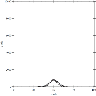

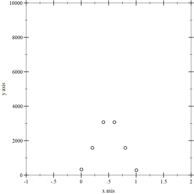

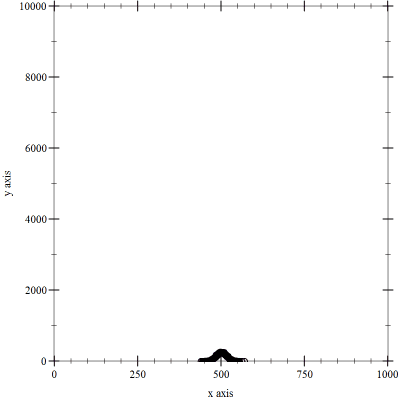

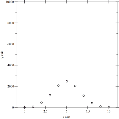

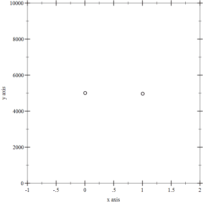

In order to illustrate the answers in this thread, I have made some simulations.
The first thing I did was to simulate a basic Bernouilli(1/2) variable. So I generated 10000 data points which were distributed Bernouilli(1/2). This is the plot of the frequencies of the data points:
As we expect, about half of the data points are in 0, and half are in 1.

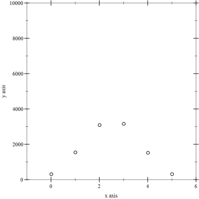

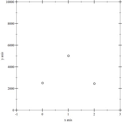

Then I took 2 data points who were Bernouilli(1/2) distributed and took the average of the two. I did this 10000 times. This is the plot of the frequencies:

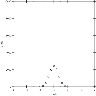

I then took 10 data points who were Bernouilli(1/2) distributed and took the average of the 10. I did this 10000 times. This is the plot of the frequencies:
I then took 100 data points who were Bernouilli(1/2) distributed and took their average. I did this 10000 times. This is the plot of the frequences:
I then took 1000 data points who were Bernouilli(1/2) distributed and took their average. I did this 10000 times. This is the plot of the frequencies:
As you see, the mean of the distribution translates to the right if I take enough data points in the average. You also see that I get very close to a normal distribution. Even if I only take averages of 10 data points, I'm already quite close! The variance also gets smaller each time (relative to the total population).
So while you are right that I can never generate negative values. We do see that the population translates to the right and since the variance gets (relatively) small. Thus the theoretical contribution from the negative values in the normal distribution gets closer and closer to 0.

@micro - Based on the x-axis in your plots, I think your simulation is summing the Bernoulli trials, not averaging them, correct?
I also noticed that I omitted a ##1/n## scale factor in my definition of ##s_n## in post #2. It should have been
$$s_n = \frac{1}{n}\sum_{k=1}^{n} x_n$$
The rest of my remarks assumed we were talking about averages, not sums.
If we sum instead of averaging, we get similar results, except the mean and standard deviation of ##\sum_{k=1}^n x_n## are ##n \mu## and ##\sqrt{n}\sigma## instead of ##\mu## and ##\sigma/\sqrt{n}##. However, the sums do NOT converge in distribution.

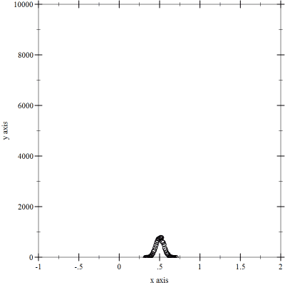

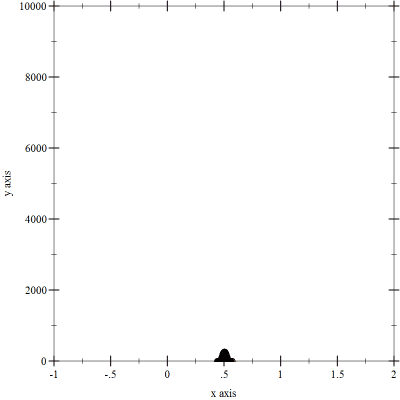

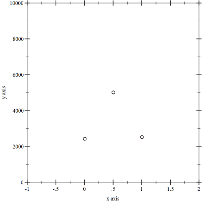

Yes, that is correct. Here are the plots for the averages:
The averages of the above plots remain the same now (as 1/2). But the variances decrease each time. So the corresponding normal distributions have variances which decrease. So the negative points have probabilities which decrease to 0.
