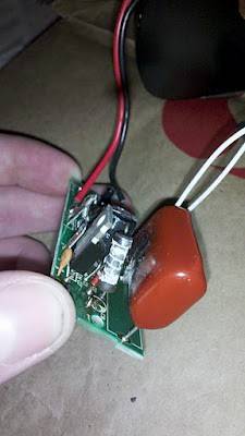

I am trying to repair this device and have determined that the issue is with this melted resistor... In order to find the correct replacement i need to determine specifically what resistor this is.
Measuring the resistance won't answer the question, because if it got hot enough to burn off the paint its value will have changed (and it might now be either open or short circuit, of course).
If you can't find the circuit diagram, your best plan is to draw out the circuit, figure out how it works, and find the value that way. Presumably you know what the circuit is supposed to do.
If you post the circuit here after you've drawn it out (including the other component values) somebody here will probably help if you don't know how to analyse it.
Also, the resistor has obviously failed, but that might be collateral damage, not the root cause of the failure. In that case, just replacing the resistor won't achieve anything, except to incinerate another resistor.
You can get an idea of the resistor value by measuring what its resistance is now.
Resistors tend to go higher in resistance when they are cooked like this, so the original value of the resistance was likely to be less than it is now.
So, if it is 30 ohms now, its previous value may have been less than 30 ohms.
However, resistors rarely fail catastrophically like this by themselves and (as already mentioned) they usually get destroyed by something else failing.
Prime candidates are semiconductors (diodes, transistors...) or capacitors.
So, you could look for shorted capacitors and semiconductors.

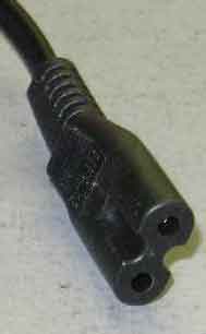

Another theory for outside interference that could have damaged it: This device used a plug that looks like this
This connection was really loose, and any bumping of this device would cause the device to flicker and make an ominous quiet sparking sound. I got so fed up with this that I ended up cutting the connector head off of the cable, feeding it through the hole in the box where the female connector was and soldering it straight to the power wires. This fixed the problem quite nicely (don't worry I taped off the exposed solders to prevent shorts). However I worry that the amount of time that I let the device be derpy might have caused enough power spikes to fry stuff..
Does that sound like circumstances that could cause this kind of damage?
That plug is usually used for mains voltage appliances, which means you probably shouldn't be doing this.
Do not touch any part of the circuit board if power is applied.
It is possible for these plugs to make a bad connection, but that would not normally cause a resistor to burn out.
The capacitor next to the burnt resistor could be faulty, or it may just have got hot from the resistor next to it.
What is the function of the circuit board with the burnt out resistor on it?
The large black thing next to the resistor looks like a power transistor or possibly a triac.
If you test the resistance between the leads of this, then none of them should be less than, say 300 ohms.
If you find any with resistance less than this, the transistor may be faulty.

I am going to stick my neck out here and suggest another analysis.
Firstly the resistor, although obvously overheated may well not be destroyed, because it looks like a wire wound power type and the wire appears intact. If so, this will not have changed its resistance on cooling. Obviously the protective ceramic coating has burned away so the components needs replacing.
This resistor is likely to have quite a low value, difficult to check accurately with a cheap multimeter.
Capacitors?
I can see (not very well) three caps in the picture. they are unlikely to have suffered, in particular the big orange one looks very healthy.
You can check caps with a multimeter by connecting the ohmeter. As you connect the reading should 'blip' and then gradually rise towards infinity on a good cap. Analog meters with a needle are best for this. You cannot readily measure value this way.
The power controller?
I can't see any rectifiers so this is likely a thyristor/triac. Does it have any markings/ letters. Post these. It may well have failed. Multimeter check on these are unreliable.
And the probable cause of failure?
Well I'd say that the load element has overloaded the controller circuit for some reason. Perhaps it has gone (partial) short circuit.

I am 90% sure of the following but I write it as if I am 100% sure. You need to confirm with a meter.
The large capacitor is a series ballast. It has most likely gone bad. It works by acting like a large lossless voltage drop at 60 Hz. The black cube is a three-terminal voltage regulator which still works and is powering the micro. It has a built-in thermal shutdown which is why it quits.

There is no transformer mentioned and the control circuitry requires a DC voltage very much lower than mains either.
The tub or can capacitors shown are low voltage types. This applies particularly to the larger black one.
The integrated circuit requires a low DC supply voltage.
VK6kro if you have identified it this should tell us this voltage.
This DC voltage will be supplied from the three legged black device which I think we are all now agreed is a voltage regulator.
We can therefore type the voltage regulator from the standard supply voltage of the IC.
Since there is no transformer either
The mains is directly rectified by IN4003 diodes and dropped by the burnt resistor to low voltage input to the regulator.
This is unlikely as the board is laid out so that this would mean exposed high voltage components leads.
or
The mains is dropped by the burnt resistor and the low voltage inputs to 1N4001 rectifiers and the filter capacitor to provide a DC input to the regulator.
Either way, Beware, the exposed top of the burnt resistor could be at high voltage.
Please check what each end of that resistor is directly connected to.
1N series rectifiers are rated for 1 amp current so that will also be the rating of the regulator.
Please also check what other components the heater terminals are directly connected to on the board.
Further there should be a rating plate somewhere on the apparatus, stating the wattage voltage and current, or at least two of these. What does the plate say?
Please also check what the three legged device, we are calling a regulator, is connected to as it still might be a thyristor controlled from the IC and supplied by the four rectifiers. ie one method of mains control is to rectify it to DC and drive the load (heater) through a controlled switch from this rectified DC.
In this case there will be no regulator.
Either way the burnt resistor will act as a voltage dropper to provide the DC supply for the IC.
However its value will be determined by whether or not is passes the heater current or just the IC supply current.
A final word of warning.
