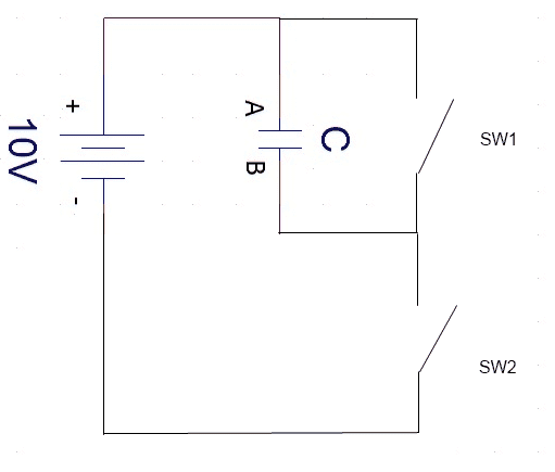

Ok I see the switch is in red.
So the initial conditions are switch open and the capacitor discharged.
It's necessary to state that the following voltages are measured with respect to the -ve terminal of the battery...
The A terminal of the capacitor (and point X) is the same voltage as the +ve terminal as the battery eg 10V.
The B terminal of the capacitor (and point Y) is the same voltage as the A terminal (eg 10V) because the capacitor is discharged.
The way to think of this is that at t=0 when the switch is closed/ON the B terminal of the capacitor will be "pulled down" from 10V to 0V.
Consider this circuit.
The discharged condition is represented by SW1 closed and SW2 open.
The charged condition is represented by SW1 open and SW2 closed.
