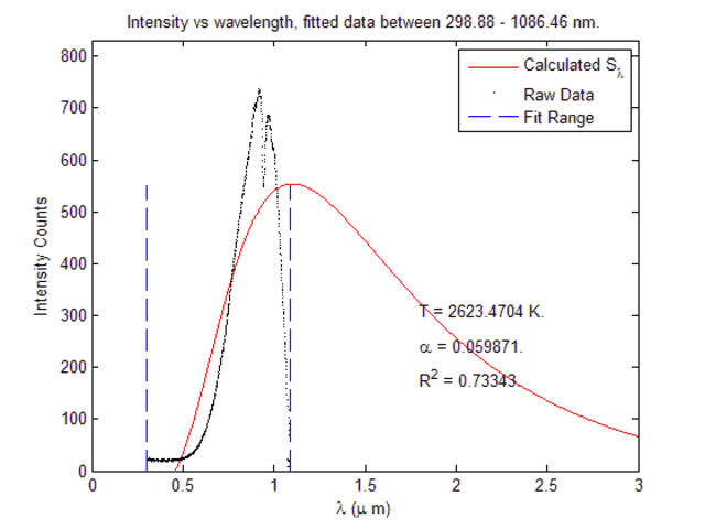

Here is more on the experiment.
Took a spectrometer to a light bulb and recorded the data.
Fit the data to this function:
Sλ = 2πc2hα / λ5(ehc/λkT -1) + constant

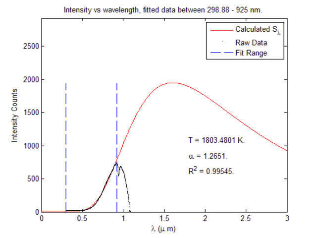

Here are two plots illustrating the difference this makes.
The data shown is raw, the difference between the plots is whether data is excluded before the fitting.
Data points outside the blue dotted lines were not used when fitting.
Throwing out data is a bit of an art. Throw out too much and you run the risk of doctoring the data, of seeing a conclusion that is not justified. Use all of it, and as you have seen, you run the risk of bad data corrupting your results.
Given that double peak, coupled with the bad fit, it looks as if you are using the spectrometer beyond the range it should be used in. Have you looked at the spectrometer's specification manual?
I assumed it wouldn't gather data beyond it's usable range. But that's worth looking into. thanks.
You need to find out more about your spectrometer. Do you have recent calibration data? Take some shots of a calibrated lamp
Definitely falls into the category, 'Something's messed up with the measurement device.'

I'm going to approach this from the point of view of an experimentalist in the audience. I would like to see the full data first, and then, see what you had done in your analysis. And I think, this is typically a good approach.
Assuming that you have no plausible explanation for the deviation, and assuming that you have no clue on an explanation to justify not counting those "naughty" data points, what you should do is
(i) present the entire data and do a fit on the data.
(ii) then show that if you do not include the rogue data points, it is a better fit.
This way, you are being honest. You may tell them that, at this point, you do not have a good explanation on why there are data points that do not follow the description. This way, you have not thrown away any data points in your presentation, and you've given your audience the ability to decide for themselves if they want to accept those data points. But at the very least, you are not hiding from them things that you can't accommodate or explain.
However, if you do have a plausible explanation, and I'm seeing several posts in this thread on what possibly could have happened, then you can use such an explanation to justify why you can ignore those data points, and produce a better fit with the remaining ones. In either case, always, ALWAYS show all of your data (unless you know for sure some of them are "garbage" because of obvious errors in measurements, etc.). In many areas of physics, even instrumental errors can be interesting and illuminating, especially in research on device physics.
Zz.

You said the source was a light bulb. The bulb was made from ordinary glass, I guess, instead of quartz glass. The light bulb certainly absorbed UV radiation. So you have to discard the UV data.
Also the atmospheric gases -water vapour, ozone, absorb radiation in the visible. The dip in your spectra are from that absorption.
The detector of the spectrometer also has got sensitivity depending on the wavelength. See the response of a silicon detector.
http://upload.wikimedia.org/wikipedia/commons/4/41/Response_silicon_photodiode.svg
So the recorded data are the product of the intensity multiplied by the sensitivity of the detector.
You have to perform calibration - record a spectrum with a standard source, and modify your measured data accordingly. I suggest to use data measured in the range 400-1000 nm.
When showing measured data together with the fit, show only the range where you performed fitting.

If memory serves me correctly, the spectrometer is a QE65PRO from ocean optics, was purchased last month and calibrated by them (They state they do that). And the calibration data is stored & processed by the spectrometer. So, if I happen to be extremely fortunate, I may not have to.
Regardless, I will at least check to make sure. I probably will end up doing a calibration like that.
I am also planning to exclude small ranges corresponding to absorption lines, like you mentioned (not that far into it yet).
From what I've gathered on here and from OO's website, the usable domain of wavelengths depends on the grating in the spectrometer and the slit diameter. I don't know how to find these two things out (without taking the spectrometer apart), so I'll be calling them tomorrow or friday to ask what it was shipped with.
The range of the detector of your spectrometer is 200-1100 nm. Basically the spectrometer is used to scan transmittance/absorbance, and this one also measures Raman and flourescence spectra. As you measure the emission of a light bulb, you used the spectrometer in fluorescence mode, I guess.
When you measure with a spectrometer, you always have to scan a base line first, and then correct the row data with it. Read the handbook of the spectrometer how to perform the measurement.
