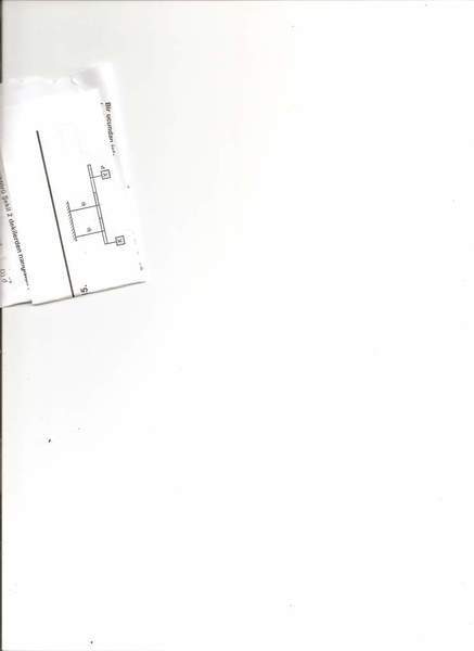

Smooth and identical rod has a weight of P. The rod seems to be in equilibrium with X and Y which has a weight of P. What can be the weight of X according to the values below?(ip means rope)
P , 6P or 9P
I tried to find the torque. First I found the gravity center of the rod. It is 2.5 units from X and 2.5 units from Y. And found the answer as
2.5P=2.5X and X=P. But according to my book there are 2 values for X. One of them is 6P and the other is P.
Think about what happens if X gets heavier and heavier. When X reaches a certain weight, the rod will begin to rotate in which direction and about which rope?
Likewise, think about what happens if X gets lighter and lighter.
6X=3P+P
x=2/3
