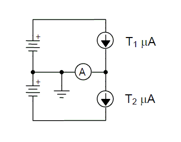

AD590 is a temperature sensor, through which a current of 1µA/K flows. AD590 is a sort of temperature sensitive transistor and can be interpreted as a current source. With two such sensors, you would like to measure the difference between temperatures T1 and T2 using a DMM. How to connect the sensors if you only have resistors of any kind and the two supply voltages + 12 V and - 12 V at your disposal? Draw a circuit, as simple as possible.
Ohm's law, Kirchhoff's circuit laws.
I came up with this circuit. The temperature sensors are the double ring symbols. Vcc=12V. I imagine that depending on the current I1 from e.g. the sensor in the left branch, the potential will fall 1k*I1 over the resistor to the left. The corresponding thing happens in the right branch, but with a different current I2. So now you should be able to read the temperature as the potential difference U. The temperature difference should be the the value for the potential difference measured in mV.
https://www.physicsforums.com/attachment.php?attachmentid=18447&stc=1&d=1239647527
But the correct answer is the following (temperature sensors are the circles with arrows inside):
Questions
1) Is my solution also correct? If not, why?
2) I understand that due to Kirchhoff's current law, you will have the difference in currents through the horizontal branch in the second drawing above. But a) why do I need two voltage sources (batteries)?, and b) why do I need a grounding point?, and c) is this grounding point the real planet earth, or is it just a reference potential? and finally d) if it's a reference potential, where is it really connected to the rest of the circuit? (I'm always getting confused when talking about grounding...) :confused:
Any help appreciated! :smile:

That being said, do you at least understand how the "correct" circuit works? If the temperatures are equal, both current sources produce the same current, hence no current flows through the ammeter.

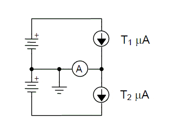

Questions
There is definitely more than 1 way to do this.
You're circuit will work in principle. A potential issue relates to accuracy. The 2 resistors in your circuit must be well matched so that zero ΔT results in zero signal (or reasonably close, it depends what are the requirements on accuracy).
Note that the "correct" circuit is a more direct measurement, the two currents are simply subtracted at the node common to the two AD590's to produce the ammeter current.

Ah, thanks! :smile: Then I was thinking, at least in principle, correct.
But now to the physics in the circuit with the ammeter. Do I really need two voltage sources? And what happens if I take away the grounding point? I don't know how to think there...
Yes, in that circuit separate voltage sources are needed for each AD590. Relative to the common point of the two AD590's, the other terminal is at a positive voltage on one of them, and at a negative voltage on the other.
If the grounding point is removed, the circuit will still theoretically work. If the voltages and currents are at safely low levels, it's not necessary to physically ground the circuit to the case. It would depend whether the device is powered, for example, by a wall plug (grounding necessary for safety reasons) or by two 9V batteries (grounding not necessary).
Hope that helps.

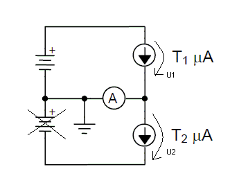

Hm... Still a little bit unsure. Suppose I take away the lower battery (I short-circuit there). Then, wouldn't I get a potential fall U1 first over the first sensor T1, and then an other potential fall U2 over the second sensor T2? Or do you mean that all the potential falls over T1, so there's nothing left to fall over T2, and why so in that case? See figure below how I mean:

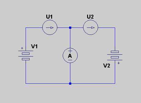

Here's another view of the same circuit, which might help see what's going on better:
Each voltage source supplies power to one and only one of the AD590's.
If we short out one of the voltage sources, say V2, the corresponding AD590 (U2) will not produce any appreciable current. If we consider the ammeter to be a short as well, that would mean zero voltage and zero current from U2. The ammeter will then simply register the current from U1.
Okey, I think I got it sort of.
I guess I should know this... so if you have two branches and one of them have 0 resistance (the middle branch in the above fig), and the other have > 0 resistance (the branch to the right in the above fig, and suppose the battery to the right is not there as well), all the current will go in the branch with 0 resistance. Hm... but why is it really so? There's still a potential, why won't any electrons be affected and start to move in the branch to the right with > 0 resistance?
The branch with 0 resistance must have 0 voltage as well, because
V = I R = I*0 = 0​
The two branches are in parallel, and therefore have the same V=0.
The branch with R>0 must have zero current because
I = V/R = 0/R = 0 (only if R≠0)​
