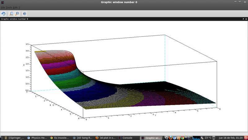

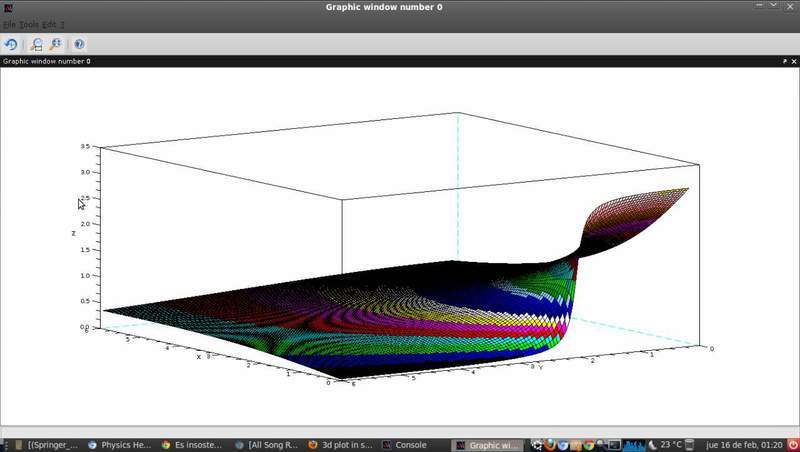

I think the reason you are getting a flat surface is because you have yet another typo which effectively makes the summation be zero...
in your numerators, you have Y-2 and 2-Y ...you should have Y+2 and 2-Y
and, for completeness, you may want to put back the division by PI
Whoops you're right. Well since I took a=2 while it's totally arbitrary, I don't think the 1/pi factor is really relevant.
Using the meshgrid I get a somehow decent surface, but doesn't work well for the plot3d command so far.
Here are 2 screenshots.

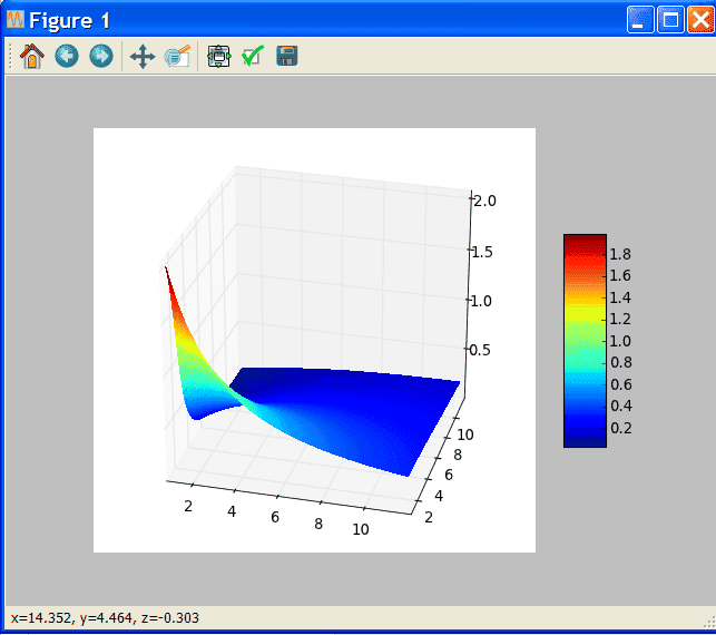

Hhhmm...here it is what it looks like with python and matplotlib.
Maybe it's the same. If you take a=2, I suggest you to reduce the box up to y and x=6 rather than 12.
