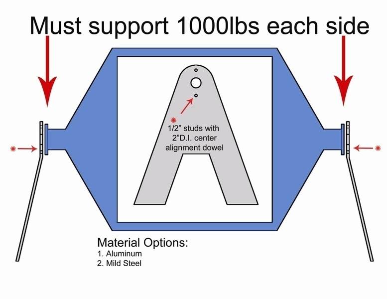

I have a question regarding what material type and thickness could support a given load most cost effectively. Weight of the part will also be a factor in the cost due to the wacked out freight charges these days.
I have no idea where to locate the information that I need or a formula so that I can figure it out myself. I am not a engineer by trade but I am a quick study.
I am trying to make a couple of support stands for a machine. I already have all of the drawings done and now I just need to pick out the correct material for the job. Also I have considered revising the design but in all honesty this is the best way all things considered and I do mean all things (Shipping size, shipping weight, packing etc...)
I would like to know the following regarding aluminum and mild steel:
NOTE: The stands are 24" tall for scaling purposes
Based on the attached picture, which is more suitable, Mild steel or aluminum? Also what thickness would each need to be in order to support the said load?
Any and all help would be greatly appreciated

One can find material properties here.
http://www.matweb.com/search/MaterialGroupSearch.aspx
Probably mild steel would be the way to go, as opposed to Al. Depending on the Al alloy, one would have to make a thicker part from Al than from steel in order to achieve the same marging to yield strength.
There is also the matter of geometric design, e.g., type of a channel/column, as well as the base. The supporting system might be a like a cradle of some kind.

Not true, mild steel just doesn't have the strength of high strength aluminum alloys and it weighs more to boot.
Aluminum 6061-T6 or 7075-T6 has a very good strength to weight ratio compared to mild steel. Mild steel like A36 has a yield strength of about 36 ksi, while Al 6061-T6 has a yield strength of about 35-40 ksi and only 34% the density of A36 steel (this means a part made out of aluminum would weigh 34% that of an A36 steel part of the same strength). Al 7075-T6 has a yield strength of 73 ksi and 36% the density of A36, making it even stronger.

That was my understanding in a nutshell but I wanted to verify it before I began trying to select the correct material that will support the vertical load (Static Load?) and the lateral forces (Term?) that are due to the 10deg Outward Brake on each leg that were put there for stability reasons.
Since I do not have a formal education in this field I am going to need to know a few simple things as well as how to calculate and/or search for the solution/answers myself in the future. I am not expecting a teaching lesson or anything, I would mearly like to know the basics and anything else you all are willing to teach to a sponge. lol
So I need to know how to locate as well as identify the proper material, in aluminum or mild steel, to support the load in the configuration that was in my attached drawing.
Also, what would be the answer for Mild Steel and Aluminum?
Any further help would be great. Again I am a newb here but I am ready and willing to learn whatever you got.

I wasn't thinking of high strength Al alloys, but more along the lines of comparable low strength Al alloys, like 1100, since the OP was comparing it to relatively low strength mild steels.

Am I correct in assuming that this stand is a transit stand, not a long term mounting for a machine in use?
Can I also ask about the fixing down design? I would advise you to check this aspect carefully as substantial shock loads can develop during transit.
This is a key aspect of design. Anything in transit must be designed to take dynamic/transient/impact loads that might be experienced during transport/transit. These are well above static loads.
Nuclear fuel designers must consider 4g axial and 6g transverse accelerations, which are well above loads expected in service, but could be expected in a transport mishap.
Ideally a material has quite a separation between YS and UTS. Usually the operating stresses are well below YS - i.e., no plastic deformation allowed. If YS is exceeded, the part/system may be unusuable and must be scrapped.

The stands are for servicing only, so the load will remain static.
I am assuming that the material that I need for this load will not fall under the "sheet metal" category due to the needed thickness, is that correct?
If so then what category should I be looking in where the material is large enough to cut out these parts with a water jet?
I figured I would give you some more details to help with the proper material selection.
-The max load the stands will see is 1000lbs each and on the 4000lb machines we will be able to use 1 on each of the 4 corners.
-The drawing does not look exactly like the final stand but for material selection I think it should be good enoughAlso, let's also say that I removed the bend, what thickness and type of aluminum and mild steel would be appropriate for this application with the given static load remaining the same?
