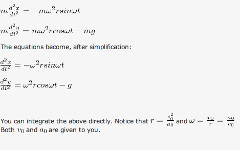

If the pilot is, indeed, flying in a perfect circle then his acceleration must be constant and always pointing toward the center of the circle. You say "initial centripetal acceleration is 30 m/s2 in the direction vertically upwards" so his acceleration is always 30 m/s^2 pointing toward the center of the circle.
Any circle can be given in parametric equations as [itex]x= -R sin(\theta)[/itex], [itex]y= R cos(\theta)[/itex] where, here, x is the horizontal distance right or left of the center of the circle and y is the vertical distance above or below the center of the circle. R is the radius of the circle and (x, y), when [itex]\theta= 0[/itex], is the starting position at the bottom of the loop. Assuming a constant angular speed, we can write [itex]\theta= \omega t[/itex] where [itex]\omega[/itex] is the angular velocity and t the time.
Differentiating, [itex]dx/dt= -R\omega cos(\omega t)[/itex] and [itex]dy/dt= -R\omega sin(\omega t)[/itex].
We are told that, at the beginning of the loop, when t= 0, the airplane has a horizontal speed of 60 m/ so we have [itex]dx/dt(0)= -R\omega= 44[/itex].
The net acceleration is the second derivative, [itex]d^2x/dt^2= R\omega^2 sin(\omega t)[/itex] and [itex]d^y/dt^2= R\omega^2 cos(\omega t)[/itex]. We are told that, at the beginning of the loop, when t= 0, the airplane has an initial vertical acceleration of 30 m/s^2 so we must have [itex]R\omega^2= 30[/itex].
From those two equations, [itex]R\omega= 60[/itex] and [itex]R\omega^2= 30[/itex], you can solve for both R and [itex]\omega[/itex] and so find the parametric equations for the airplane's trajectory. Add R to the y component to move the origin to the bottom of the loop.

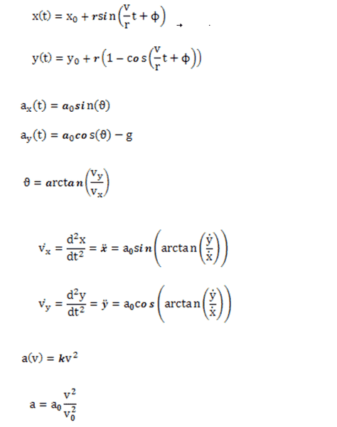

I'll try to translate this correctly.. I'll mark XXX equations I'd have to fill in.In this case we have a plane with acceleration, which is at all times orthogonal to the movement of a plane.
If we would describe the movement in a horizontal plane (without the effect of a gravitational force) we would get a movement along a circural path.
1) a = a_0 x ( V_2^2 / V_0^2 )
2) a_0So we have;
V_0 ... initial speed
XXX1 ... initial position
XXX2 ... speed of the plane
XXX3 ... radius of the circle
XXX4 ... initial slope of the plane at a start
We should get two equations:
3) XXX5
4) XXX6
where XXX7 is defined as
5) XXX8Here XXX9 is the speed of the plane in x direction, XXX10 is the speed of the plane in y direction.
From this equations we get two diferential equations for the position in the x and y direction.
6) XXX11
and
7) XXX12Somehow we have to take into account also a quadratic dependence of the components of the acceleration, perpendicular to the direction of the movement of the speed:
a(v) + k v*v
that's why
Along this aerodynamic component there is also the acceleration due to gravity, which always points down.
Now, I don't know what XXX's are .. Anyone?Also, someone suggested this (also by Euler's method)

Does the following make sense? :
θ = ω * t ... angle between the position of the plane in the vertical going through the center of the loop

What about this, what I sent to my professor (but he didn't check if it's right yet). These are simpler equations and a graph look right to me.
EQUATIONS:
// Acceleration
var Ax = -39.8 * V_t * Vy_1 / (60 * 60);
var Ay = 39.8 * V_t * Vx_1 / (60 * 60) - 9.8;
// Velocity
Vx_2 = Vx_1 + Ax * delta_t;
Vy_2 = Vy_1 + Ay * delta_t;
// Position
x_2 = x_1 + (Vx_1) * delta_t;
y_2 = y_1 + (Vy_1) * delta_t;RESULTS:
