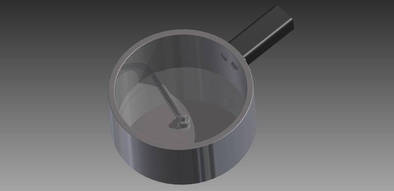

Hi my names Oliver and I'm new to this but I am currently studying engineering, maths and physics A levels and as part of my engineering I have to create an innovative product. My idea is a saucepan with a built in device to stir the contents without the need for human interaction. So far I've thought of a rotating form of blade on a pivot in the centre, however I've been thinking how to power it. I don't want to use electronics because it would get awkward with the heat so I've been thinking along the lines of convection currents, however I've never really studied them into great depths through my AS years so I don't know a great deal about them. So my question is could convection currents generate enough power to rotate a metal blade around a pivot? I've included a picture for anyone that doesn't understand my idea (I know I might not be that clear). And I understand about viscosity so to make It easy at the moment just say the saucepan is full of water.
thanks for your time and replies if there's any more information needed just ask and I'll reply when I can.

Convection currents stir the contents to some extent anyway. The problem is likely to be that convection is too slow to prevent burning especially in high viscosity liquids like soup.
If you put a blade in there, the blade will probably _slow down_ the convection currents, rather than increase them, unless you put some external power into the blades. Think about it: if it takes power to turn the blades, then where is the power coming from?

Oh well, I can imagine you can power such a thing in water - with an additional blade somewhere to catch a convective flow and some means of directing this (sounds like a cleaning nightmare on its own). For other liquids (in particular, everything where such a thing could help) I doubt that you get enough convection.

Could you make the pan bi-metallic in such a way as to generate thermo-electric power using the temperature difference between the sides and bottom, and then use that power to turn your blade? Making this thermo-electric power source and motor an add-on to the pan would be awkward, but casting the pan with the different metals in different places to produce the desired currents, magnetic fields, and ultimately, movement of the rotor, could be pretty elegant.

Except the efficiency of thermocouples depends upon temperature difference and you wouldn't be considering more than 10 C. There could be many more 'cordless' ways of getting power to a stirrer than a thermocouple. The old magnetic stirrer is a good system but that is limited to low viscosity liquids. Perhaps an acoustic agitator would work.
