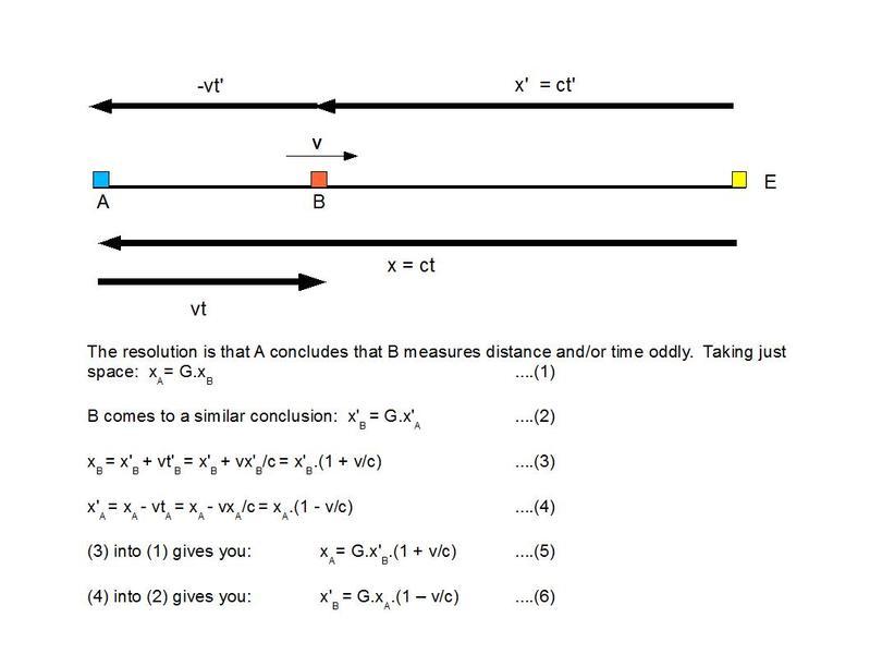

OK, here are the four diagrams I drew up, apologies for the messiness. The first one shows my understanding of what the terms in your equation mean in a spacetime diagram. The second shows what the terms mean in the spatial part of the Lorentz transform equation delta-x = gamma*(delta-x' + v*delta-t'). The third shows a particular symmetry in the scenario that you use to define your terms, and in the fourth diagram this symmetry shows how the meaning of your terms xB and tB can be changed so that now the modified version of your equation does deal with only a single pair of events, making it a special case of the Lorentz transformation equation, which explains why both equations look the same. But notice that your derivation only works in the case where the pair of events have a light-like separation, and where one event is on the space axis of one frame and the other event is on the time axis of the second frame, whereas the Lorentz transformation deals works for arbitrary pairs of events that don't need to have these properties.
By the way, to make your equation more consistent with the Lorentz transformation equation I made a slight tweak to your definitions--where you defined x'A and xB in terms of the "distance" between a pair of events, and so made these positive, I picked the rule that they were defined in terms of (position coordinate of later event) - (position coordinate of earlier event), which means x'A = -5 rather than 5, and xB = -10 rather than 10. So the tweaked version of your equation relating them ends up being x'A = gamma*(xB + v*tB).

  • #250
I'm not going to try to explain in your terms, since your diagrams show that you have gone off on some tangent.
I've tried explaining in your terms and that doesn't seem to work.
Can you try to understand in my terms?
Here is a very busy little diagram and a less busy diagram. I've gone all the way back to the beginning so anything I have said in between to try to explain in your terms is defunct, so please try to start from here.
The diagrams may well contain all you need to understand. If they don't, then we can discuss the diagrams in my terms. Once we are both happy that you understand what I am actually talking about in my terms, then we can try to convert things into your terms. Does that sound fair?
(Note that the temporal component is not there, let's get the spatial component sorted out before we complicate things.)
cheers,
neopolitan
PS I noticed that the definitions were difficult to read on the very busy little diagram, so I have attached them separately in a more readable format.

My first diagram posted on this thread was yours. Otherwise there was one at https://www.physicsforums.com/showpost.php?p=2160139&postcount=156". I don't think that is the one you mean though.
You could mean the first one posted http://www.geocities.com/neopolitonian/index.htm".
Or maybe you mean the first of my most recent drawings (a couple of posts ago).
In any event, I sort of see what you are getting at but your first drawing (and in fact the rest) implies that I am focussed on something that I am not focussed on. Since we don't agree about what I am talking about, it is better than I start again, rather than trying to talk to a drawing which isn't about what I am talking about. Sorry if that sounds dismissive.
I put quite a bit of time into the most recent diagrams. Did they help at all? Hopefully you can now better understand what I was getting at when I last mentioned Lorentz invariance.
cheers,
neopolitan
PS About the unimportant tweak, move your xB so it ends in Event EA, rather than beginning at photon hits A, and you will see that it crosses the tB axis at t = -6. Then move your tB so it spans t = -6 and the event which is the colocation of the photon and B. (<- this was an edit)
That's more like what I had in mind.
PPS Diagram added which shows what I mean.

See my previous post, a new drawing!

Attached are modified diagrams, highlighting something. They are messy because I don't have all the tools I need, but you should see that I have cut a bit out of mine and moved it up. If you can do it with t (your diagram) you can do it x (my diagram).

Here is the diagram I have mentioned.
According to B, B does not move. According to A, B does move, so the photon which eventually passes B is, at the event photon passes the xB axis (formerly known as event EB) a spacetime interval away from the photon spawning event (formerly known as EA) as shown by the green line.
I've been far too busy today to describe the green lines. Hopefully you'll work it out.
cheers,
neopolitan
Just quickly, the diagram should be viewed together with the second drawing from post #250. What I am focussing on is x' (both of them, ie x'A (5) and x'B (4)). With a little effort you can find vt'A (3), vtB (6), xA (8) and xB (10). I think these make more physical sense.
Something that remains to be seen is if this is a special case or not. I don't think so, but how to convince anyone else is a task for another day (or week even).

Ah, I see what you mean. Yes, that relationship works. I suppose we could name the event where the bottom red and green lights meet as EC, which could be defined as "the event that is at the same position in the A frame as the light passing B, and is simultaneous in the B frame with EA." Then it would be true that in the B frame, the distance from B to EB is equal to the distance from EC to EA.
But aren't we drawing on our prior knowledge of how spacetime diagrams in SR work (which are based on already knowing the full Lorentz transform) to conclude that this relationship holds? Are you saying you could derive this relationship from first principles without first knowing (or first deriving) the full Lorentz transform? If not, how does this relate to your attempt to derive the Lorentz transform?
  • #266

Well, in your original derivation, the terms in the equation x'A = gamma*(xB - vtB) definitely referred to coordinate distances and times between pairs of events with a lightlike separation...if you're saying that you think you could derive a similar-looking equation but where the terms had a different physical meaning, and derive it from first principles without relying on preexisting knowledge of how spacetime diagrams in SR look, then to convince me of that I think you'd really have to go back and go through the steps of the altered derivation from the beginning. I don't know if that's worth the effort at this point though, it's up to you. Also, are you saying you think you could derive it for events at arbitrary pairs of coordinates, or only in the case where we've oriented the x-axis so both events are simultaneous (or colocated) in one of the frames? If the latter that's still not as general as the Lorentz transformation, which can be applied to events that need not be simultaneous or colocated in either of the two frames.
  • #268
My original derivation at https://www.physicsforums.com/showpost.php?p=2165684&postcount=174".
In that post I said to put (7) and (4) into (2), where:
(2) x'B = G.x'A
(4) x'A = xA - v.tA
(7) G = [tex]\gamma[/tex]
giving
x'B = G.( xA - v.tA )
so that x'A actually disappears. I'm not saying that x'A has no meaning at all, but I do wonder if it should (or at least could) perhaps be used as an interim value. The value xA in this equation is the spatial separation between the origin of the xA axis and the event formerly known as EA. These two events don't have a lightlike separation. (And here I can point out that I am totally aware that events don't have to have anything happen at them. I was mistakenly under the impression that you wanted to tie "happenings" to events as part of your desire to have physical meanings to all the various values. The notional colocation of A and B event is part of this, even though in reality A and B don't ever have to be colocated - they can start separated and head off in opposite directions in a 1+1 universe, or just have a nearest point of approach in a 3+1 universe.)
There is no altered derivation from post #174. It stands. Each of the values may well have a better physical definition, but those better definitions don't change the derivation.
Everything between #174 and here has been to get those better definitions and while it has been quite a journey, I don't think that it has been in vain. At first I was confident that my derivation works, but that confidence was based on a rather nebulous mental picture which was clearly difficult to express in words. Now I am confident that my derivation works, and my confidence is based on a much clearer mental picture which I believe I can present in a spacetime diagram.
A clarification, do you realize that the image given in https://www.physicsforums.com/showpost.php?p=2178288&postcount=264" only refers to the spatial component of a spacetime interval?
cheers,
neopolitan

I did think about that shortly after I wrote #227. You can eliminate x'B and xA or xB and x'A depending on what you are after. When I wrote #227, I was really just showing that G could be gamma or 1/gamma, depending on where you initially put G but what you ended up with (a Lorentz transformation - or "Lorentz-like") didn't change. I should have either not gone any further than that or, if I did, I should have eliminated xB and x'A to remain consistent with #174.
JesseM said:
I don't think the equation from post 174 could actually be derived using your later definitions that you were using in post 227 and later posts; in post 227 you wrote:
Substituting, the equations you could get from this would be either x'A = (xB - vtB)*gamma, which is what you derived, or x'B + vtB = xA*gamma, which doesn't really look like a Lorentz transformation equation at all.
As I said I don't think you can actually derive x'B = G.( xA - v.tA ) using the definitions from post 227 and subsequently. Even if you could, this would not really be much like the Lorentz transformation equation, because it doesn't relate the coordinates of a single event or single pair of events in two different frames--x'B represents the position of EB in the B frame (or equivalently the distance between EB and the event of light passing B in the B frame), while xA represents the position of EA in the A frame (or equivalently the distance between EA and the event of light passing A in the A frame) and tA represents the time of the light passing A in the the A frame (or equivalently the time between EA and the event of light passing A in the A frame, the same pair of events you might use to define xA, except that if you want to define both xA and tA in terms of this pair of events then one of them must be negative if you're consistent about the order you take the events).
With the understanding of what x'B is, and how it relates to x'A and xA and xB in the diagram at #264, do you agree that the equations at #174 work?
I repeat yet again that I have been trying to work out why this thing works. And I think it does.
Part of the process of trying to work out why works was a discussion which we have conducted which has involved what I can see are some false starts and some dead ends from which I have had to retreat and start off again. Add to that the problems I have had with coding up replies (misplaced primes, misplaced subscripts) and it's a mess.
How about we take a pause for a bit while I fix what is wrong in #174 (as far as I can tell), then I make a temporal version of what is explained in the diagram in #264, I can repose the question from three paragraphs up and we can go from there? When I redo #174, I will put what is in the post into a diagram, because I find it so much better to use a WYSIWYG interface than the Latex reference interface - especially when I am strapped for time.
cheers,
neopolitan
  • #271
Some diagrams posted http://www.geocities.com/neopolitonian/gen.htm". Some more to come, when I get to the machine the originals were created on.
If there are comments at this stage, please keep them to where I have stuffed up (there's bound to be something).
cheers,
neopolitonian
  • #272
But how do you actually derive x'B = gamma*(xA - vtA)? Are you still defining x'A and xB like this?
x'A=xA - vt'A
xB=x'B + vtB
Then if you want to write the G equations as in #174 (which will make G = 1/gamma) that'd be:
xA = xB*G
x'B = x'A*G
(by the way, I should add that although I never got into it, I wasn't really happy with your answer in post 227 to why you assumed the G factor would be the same in both equations--you cited 'Galilean invariance', but how can you use Galilean invariance as a starting assumption in a derivation that's supposed to give SR equations, when Galilean invariance explicitly contradicts SR? Maybe you just meant 'invariance of the laws of physics in different inertial frames', i.e. the 'principle of relativity' that works in both Galilean relativity and SR? Even then I think more work would be needed to justify this step, because the physical situations aren't totally symmetric, in A's frame B is moving towards the photon while in B's frame A is moving away from the photon...)
Then I guess the next step would be the substitution t'A = x'A/c and tB = xB/c...I guess the justification here is that these terms can be defined using events on the path of a photon, for example t'A is (time in the A frame between EA and photon reaching B) while x'A basically means (distance in A frame between EA and photon reaching B).
Anyway, with that substitution you'd have:
x'A=xA - vx'A/c --> xA = x'A*(1 + v/c)
and
xB=x'B + vxB/c --> x'B = xB*(1 - v/c)
Then you can take xA = x'A*(1 + v/c) and x'B = xB*(1 - v/c) and combine with the G equations xA = xB*G and x'B = x'A*G giving:
x'A*(1 + v/c) = xB*G
xB*(1 - v/c) = x'A*G
which combine to give [x'A*(1 + v/c)/G] * (1 - v/c) = x'[/sub]A[/sub]*G which implies G^2 = (1 + v/c)*(1 - v/c), so G = 1/gamma.
So, x'B = x'A*G becomes x'A = gamma*x'B, and xA = xB*G becomes xB = gamma*xA.
But then what's next? Is there a way to combine those equations with the original definitions of x'A and xB, namely x'A=xA - vt'A and xB=x'B + vtB, to yield the desired equation x'B = gamma*(xA - vtA)? If there is I'm not seeing how.
Just in terms of the numbers, sure, if x'B = 4 and xA = 8 and tA = 8, then x'B = gamma*(xA - vtA) works out. But I don't see how to actually derive that equation from your starting definitions. Also, as I said, the physical meaning of the terms, in particular why xA and tA are both positive, is ambiguous to me:
So, which of these definitions is the reason that xA and tA are both positive?
1) they are the coordinates of two different individual events--xA is the position coordinate of EA in the A frame while tA is the time coordinate of the event of light passing A in the A frame
2) they represent the coordinate distance and time between a single pair of events, but taken in different order--xA = (position of event EA) - (position of event of light passing A), while tA = (time of event of light passing A) - (time of event EA)
3) Similar to 3, but they are defined as the absolute value of (coordinate of one event) - (coordinate of other event), so the order doesn't matter
4) Something else?
I assume whichever definition you adopt, the definitions for x'B and t'B would be analogous. Also, if you want to change the definitions a little so xA involves taking the events in the same order as tA, meaning that xA will actually be negative (my 'tweak'), that would make things a lot simpler so feel free to take that option (in this case the rest of the proof should work if you do some other tweaks as well, like defining x'A as xA + vt'A so that it refers to [position of light passing B] - [position of EA]).
Sounds good, all of that would be helpful. If you want to go back and redo derivations I do recommend using the tweak above where coordinate distances and times between pairs of events are always consistent about the order so that they can sometimes be negative...it's up to you though.

  • #275
JesseM said:
The idea that the laws of physics are invariant across inertial frames is known as the "principle of relativity" (which can mean either Galilean relativity or SR relativity depending on the context), while Galilean invariance is defined as the principle that the laws of physics are invariant under the Galilei transform (x' = x - vt and t' = t). Using these definitions, while it makes sense to assume the principle of relativity in a derivation of the Lorentz transformation, it wouldn't make sense to assume Galilean invariance since this assumption is logically incompatible with the idea that light moves at c in all frames, so I'd suggest changing your terminology here to bring it in line with the way physicists would understand these terms. In any case, even if you're talking about the principle of relativity I don't think that's sufficient to justify the claim that the same G factor should appear in xA = xB*G and x'B = x'A*G because these symbols represent coordinate distances and times for particular events in a particular physical scenario, these equations don't represent general laws of physics.
I was using "Galilean invariance or Galilean relativity is a principle of relativity which states that the fundamental laws of physics are the same in all inertial frames." - http://en.wikipedia.org/wiki/Galilean_invariance"
I do note that subsequently in that article it gives the axioms of Newtonian relativity which are the absoluteness of space and the universality of time.
Remember I originally said something along the lines of "according to each,the other measures space oddly". I've tired to avoid that terminology. Instead I showed that there is some difference between how each measures space and how the other measures space, and kept an element of invariance (or relativity) - that neither frame is privileged.
That would mean that according to A, a spatial interval measured in A's frame (between two events) would be measured differently in B's frame and the relationship between those spatial measurements would be identical to when, according to B, a spatial interval measured in B's frame (between the same two events) would be measured differently in A' frame.
In otherwords, according to A, when A and B are colocated, the distance between A and B and the YDE (yellow dot event) is xA. According to B, that distance (which is not when A and B are colocated), is xB. The interval is a pure distance in the A frame, so:
xB = (a factor times or fuction of).xA
According to B, when A and B are colocated, the distance between A and B and the YDE (yellow dot event) is x'B. According to A, that distance (which is not when A and B are colocated), is x'A. The interval is a pure distance in the B frame, so:
x'A = (a factor times or fuction of).x'B
I've taken the step of saying it is not a function, but a factor. I'm using prior knowledge here, but if I were to be very very particular, I could say it might be a function, but let's try a factor first then once I've found that a factor works, I can say we don't need a function.
Therefore:
xB = (a factor times).xA
x'A = (a factor times).x'B
Now I need to give (a factor times) a useful notation.
I originally chose a Thai letter, but to make it easier, instead I decided to use a Roman letter. Initially, I made (a factor times) = G. But you can quickly work out that that makes G=1/gamma. So, to make it easier - I thought - I expressed everything so that (a factor times) = 1/gamma = 1/G.
Do I need to spell that out in the derivation?
JesseM said:
Starting on your diagrams, I'm a little confused about something on the page here where you say "According to the Galilean boost, t'=t so the time that photon hits B is the same for A and B". But you can't assume the coordinates of the two observers are related by the Galilean boost if you're deriving the Lorentz transform (and in fact we know in our numerical example that the time coordinate the photon hits B is different in the A frame than it is in the B frame)--is this just another pedagogical remark about what would be true in Galilean physics that is not actually part of the derivation?
Pedagogical remark
JesseM said:
Hopefully when you write x' = x - vt at the top of that page you'd agree that this equation cannot actually be interpreted as relating A's frame to B's frame if we're assuming they both use frames where the speed of light is c as in SR...x' and x are both just different distances in A's frame, right? (If we're talking the distance between B and EA as a function of time, x would be the position coordinate of EA in A's frame while x'(t) would be the distance between B and EA in A's frame, for example.) So in this context x' = x - vt is not a Galilean boost because it's not relating the coordinates of two different frames.
Look at drawings 4 and 5 in the sequence. In those you can see x', x and vt mapped according to A (so according to A, you would know that these can be subscripted with A).
We are starting with the Galilean boost (perhaps just the equation) to go through a process to obtain the spatial Lorentz transformation (perhaps just the equation) and during that process there will points where what we have is not quite either.
x'A=xA - vtA works in both GalRel and SR, correct?
Perhaps we need to define what we mean by "boost", I just mean the equation, I am not using it to compare two frames. I am using it to tell me the answer to: "with an initial (t=0)separation of x between a body and a distant location, if that body moves towards that location with a speed of v, then what is the separation between that body and the distance location at a time t?" I am effectively comparing two frames, because I can continue doing that, for all values of t and build up a description of the frame according the body and implied frame in which the body is in motion. But that just means I can use the equation as a tool later on, if I feel like it.
JesseM said:
Also, on that page you appear to have changed the meaning of tA and t'B from what they were previously. For example, in prior posts tA represented the time in the A frame that the photon passed A (giving tA = 8, as you wrote in post 243), but based on equation (1) from that page it seems you're now using tA to represent the time in the A frame that the photon passes B (giving tA = 5...in previous posts you had t'A = 5). Do you want to change the definitions from here on out, or do you want to just treat that as an error and keep things consistent with the notation used earlier on this thread?
I did say I wanted to start again. I think I have said that a few times, but I don't want to trawl through old posts to show you that I have. So I will just repeat, I wish to start again.
I do notice that on that page, I have errors.
Firstly, time for a photon to get from YDE to A (according to A) is xA/c and the time at which a photon from YDE gets to B (according to A) is x'A/c. (Note the wording.)
The time for a photon to get from YDE to A (according to B) is xB/c and the time at which a photon from YDE gets to B (according to B) is x'B/c. (Note the wording.)
I will have to fix this because it flows on further through the document.
The end result will be the same, but it will be using better defined values. (edit - I know this, because I just jotted it down on paper and it works. It works the way I thought it did right back before I started this thread, it's just that I have a better grasp on what each of the values are.) I thought about posting the document (on geocities) and looking at it again in the cold light of day, but it's often more difficult to see mistakes in your own work.
I'll have to go back to the original document I did on this derivation (not posted in this thread) and see whether I have similar errors. That particular document was put together with much less pressure :smile:
cheers,
neopolitan

  • #277
JesseM said:
Previously xB referred to the distance between EB and the event of the photon passing A. Are you changing the definition completely now?
I don't recall ever meaning that, or writing it. I can understand how you might think it is the distance between EA and the event of the photon passing A, since this is what xA is, in the A frame. I'm not going to trawl back through old posts to look for what I said in order to defend what might well have been a typo.
JesseM said:
But in B's frame the YDE doesn't occur when A and B are colocated.
I know that.
JesseM said:
Do you mean the distance between B and the position the yellow dot occurred in the past? But in B's frame B isn't moving, so the distance between B and the position where the YDE was in the past will be the same as the distance between B and the YDE at the moment it occurred, which might already be the definition of xB, unless xB referred to the distance between A and the YDE at the moment it occurred in the B frame (see my question above).
If you can resist redefining my terms we might avoid the issue where you think the definition of xB has been something quite different to anything I have ever thought it has been (as in the question above).
In context, I thought this made sense. The distance between B and the YDE, when? Well, B is an observer, or a body, or a frame, while the YDE is an event so "at the time of the YDE" has to be "when". I even state that this is not when A and B is colocated.
We are getting buried in words. The addition of extra words may help, but I am wondering if it actually would.
JesseM said:
Distance between what two events? Is one of them the YDE? But the YDE did occur when they were colocated in A's frame, did it not? Your way of defining these terms is extremely confusing, you really need to be much more specific. Illustrating the definitions in terms of a numerical example would be helpful, then you could say things like "the YDE occurred at x=8 and t=0 in A's frame" and "I want the distance between the YDE event, which occurred at t=-6 in B's frame, and the event on B's worldline which also occurred at t=-6 in B's frame", stuff like that.
Are the spacetime diagrams of no help at all? They have numbers all over them.
JesseM said:
I don't understand what you mean by "a factor works" ('works' in what sense? Do you just mean it gives results consistent with your prior knowledge of the Lorentz transform?), and I also don't see where you justified the idea that it would be the same numerical factor in both equations.
A factor gives you a relationship which is symmetric. It could have (in another universe) demanded a function to have a symmetric relationship. But in our universe "a factor works".
Symmetry would also demand that the same numerical factor be in both equations. Remove symmetry and you have a privileged frame (not necessarily either of the frames in question, but a privileged frame somewhere that is more closely aligned to one of these two frames than to the other).
JesseM said:
That depends on what the terms mean. It would work if xA referred to the distance between B and the YDE at t=0 in the A frame (assuming the YDE occurs at that time in the A frame, so it's just a renamed EA), and x'A referred to the distance between B and the position of the YDE at some later time tA (what event defines the term tA?)
Try looking at all the diagrams. Synthesise, then respond. If I was sitting down next to you, you could do what you are doing, and I could point to things for you, but since we have this sort of correspondence, you are going to have to look at everything first and make an effort to synthesise.
Anyway, to try to help, I will do a separate diagram for the gen.htm series, which explicitly shows where the values manifest.
JesseM said:
I don't really see how you're comparing two frames--aren't all distances and times here defined in terms of frame A?
x' = x - vt
In the A frame, the unprimed frame, B is moving so all the distances to locations change with time. x' is the distance between B after a period of t and a location given by x. According to B, B is stationary, so the location given by x in the A frame is not fixed. Therefore any fixed location in the A frame varies with the rate at which A moves relative to B. You can use this to convert between frames (at least in Galilean relativity, otherwise you need a Lorentz transformation). Note that "boost" is "Galilean boost", and "Lorentz transformation" is "Lorentz transformation".
JesseM said:
If you're going to redefine all kinds of terms though, you really need to provide detailed definitions of what they mean.
Do you promise not to redefine my terms?
JesseM said:
So x'A is indeed the distance between B and the position of the YDE at the moment the photon passes B, all as measured in the A frame? If the YDE occurs at x=8, t=0 in the A frame then x'A = 5?
Yes
JesseM said:
OK, so using the above numbers, the YDE occurs at t=-6, x=10 in the B frame, therefore it will reach B at time t=4. So that means x'B = 4 in this example? But earlier you said "According to B, when A and B are colocated, the distance between A and B and the YDE (yellow dot event) is x'B." According to that definition, if A and B were colocated at x=0 in the B frame and the YDE's position was x=10, shouldn't x'B = 10?
Nope. You are using a redefined value of x'B.
cheers,
neopolitan
I'll post the updated diagram for you later.
  • #280
From post 243, here were your old definitions:
I can only refer you back to posts #227 and #224.
xA is the distance between the origin of the xA axis and EA, according to A, which is 8.
x'B is the distance between the origin of the xB axis and EB, according to B, which is 4.
tA is the time it takes a photon to travel from event EA to the origin of the xA axis, according to A, which is 8.
t'B is the time it takes a photon to travel from event EB to the origin of the xB axis, according to B, which is 4.
t'A is the time it takes a photon to travel from event EA and pass the tB axis (and hence B), according to A, which is 5.
tB is the time it takes a photon to travel from event EB and pass the tA axis (and hence B), according to B, which is 10.
x'A is the distance beween B and event EA when the photon passes B (which is, I stress, just a consequence of the spacetime location of event EA), according to A, which is 5.
xB is the distance beween A and event EB when the photon passes A (which is, I stress, just a consequence of the spacetime location of event EB), according to B, which is 10.
Also see post 224 when you wrote xB=x'B + vtB where "tB is when the photon from EB passes A according to B (eg t=10)"; since the distance between A and EB is increasing over time, if x'B was the position of EB in the B frame (which is also what you said in the quote above), then that equation also fits perfectly with the notion that xB is the distance between A and EB at the time tB when the photon passes A. Clearly you were using these definitions at one point, it wasn't a "typo".
OK, thanks. I realized you were talking about some distance at the time of YDE in B's frame, but the reason this was ambiguous was because your previous definition was "according to A, when A and B are colocated, the distance between A and B and the YDE (yellow dot event) is xA", so when you referred to "that distance" in the next sentence it was unclear if you meant the distance between A and YDE or the distance between B and YDE at the moment YDE occurred in the B frame (when A and B weren't colocated).
That was forgetful on my part, I was trying to go back through the derivation on that page in order, so when I got confused about the meaning of the terms I didn't think to skip to the end to check the diagram. So OK, I think based on the diagram I see what the definitions are (you don't show xB in the diagram, but you explained that above), but please check to see if these are right:
xA is the distance between YDE and A (in the A frame). In the example this would be 8.
xB is the distance between the YDE and B (in the B frame). That distance is 10.
x'A is the distance between YDE and the event of the light passing B (in the A frame). In this example it would be 5.
x'B is the distance between B and the event on the worldline of the light from the YDE that's simultaneous with A&B being colocated in the B frame (this is the event that was formerly known as EB--unless you have a way of defining x'B without referring to this event, could we give it some label? We could stick with EB or use some other label since you're no longer referring to the YDE as EA). In this example it would be 4.
(Based on the diagram, x'B could be defined in terms of either of the identical red lines, so I chose the top one since it was easier to state in words...if you wanted to use the bottom one, we could define another event EC which was at the meeting point of the bottom green and red lines, it would be the event which is colocated in the A frame with the photon passing B and simultaneous in the B frame with the YDE, and then x'B would be defined as the distance between EC and the YDE.)
Incidentally, if these definitions and numbers are correct then x'A = xA - vtA would imply tA is the time in the A frame that the light passes B (so tA = 5), is that right? And in xB = x'B + vt'B implies that t'B = 10...what is the physical definition of t'B, or of the equation x(t) = x'B + vt' in general? The equation x'(t) = xA - vt in the A frame had an obvious physical interpretation, x'(t) referred to the distance between B and the YDE as a function of time in the A frame, since at t=0 B was at a distance of xA from the YDE (just as A was at that moment, since they were colocated), and B was moving towards the position of the YDE with velocity v. I suppose in this case x(t) = x'B + vt' can be taken to give the distance between A and the event EB as a function of time, since x'B is the distance between EB and A&B at t'=0 in the B frame, and A is moving away from that position at velocity v.
The only problem with this definition is that when we write xB = x'B + vt'B, xB was not originally defined to mean the distance between A and EB at some time t'B. But if we choose the time t'B when the light passes A, we find that in the B frame this event occurs at position -6 and time t'B = 10, so the distance between A and EB at this moment is 10, just like the distance between B and the YDE, so I guess we can say that xB can be defined as either of these. But here I was relying on my prior knowledge of the Lorentz transform to show that the distance in the B frame (YDE to B's position) is identical to the distance in the B frame (EB to light passing A), so I think that means if you want to use the equation xB = x'B + vt'B in your derivation without assuming what you're trying to prove, you really need to define xB as the distance between EB and the light passing A...exactly the same definition you denied when I quoted it at the beginning of this post! If instead you define xB as the distance between B and the YDE at the moment it occurs, how can you justify the equation xB = x'B + vt'B ? Why should we expect that relationship to hold if we don't already know the Lorentz transformation?
Note that if we do define xB in terms of the distance between EB and the event of the light passing A, and we also return to the term EA for the YDE, then the symmetry in the definitions is much more readily apparent:
xA is the distance between EA and A (in the A frame). It would be 8.
xB is the distance between EB and the light passing A (in the B frame). It would be 10.
x'A is the distance between EA and the light passing B (in the A frame). It would be 5.
x'B is the distance between EB and B (in the B frame). It would be 4.
Why do you think "symmetry" demands that the same factor/function appear in both equations though? You haven't really justified this. The meaning of the terms in the two equations doesn't appear very symmetrical if we use your definitions--in the equation xB = (a factor times).xA, xA refers to the position of the YDE in the A frame while xB refers to the position of the YDE in the B frame, but then in the equation x'A = (a factor times).x'B, x'A is the distance in the A frame between YDE and the light passing B, while x'B is the distance in the B frame between B and EB. If we use my equivalent-but-stated-differently definitions above, then there is more of an apparent symmetry, xB = (a factor times).xA becomes:
the distance between EB and the light passing A (in the B frame) = (a factor times) the distance between EA and A (in the A frame)
And x'A = (a factor times).x'B becomes:
the distance between EA and the light passing B (in the A frame) = (a factor times) the distance between EB and B (in the B frame)
When stated this way, you can see that the second is just the first with all the A's and B's reversed. So here it is at least intuitive that it would turn out the same factor appears in both equations, although I still don't think it's really justified since the actual physical situation does not look the same in both frames (in A's frame, B is moving towards the position of EA, while in B's frame, A is moving away from the position of EB at the same speed).
