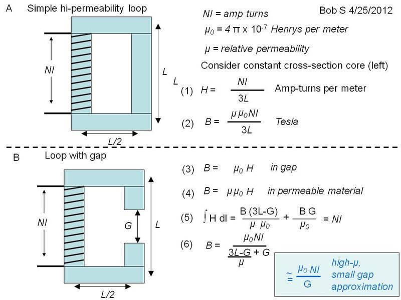

I'm working on a homemade electromagnet, to use on my racecar
I want to calculate the number of turns of an electromagnet and the thickness of the wire.
But i have tried to search arround in books, and can't really find any thing.
I know my wire is 0,114mm and dimensions for electromagnet is
Hight: 7mm
width: 12mm
lenght: 57mm
The form is like a horseshoe, but with 90* edge. Picture is linked:
http://oi47.tinypic.com/15zqlv8.jpg
My material of the core is steel (ignore the fact about type of steel)
I have 0,7 ampere for use.
