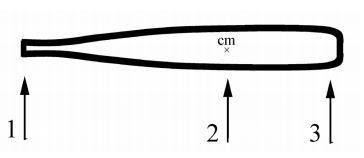

I'm brushing up on some physics in my spare time, and I was wondering if someone knowledgeable here could help me clarify the reasons behind a couple answers...much thanks in advance! =)
Question 1) The greatest linear acceleration of the center of mass of a baseball bat will be produced by pushing with a force F at...(picture attached)
A) position 1​
B) position 2​
C) position 3​
D) all the same​
E) not enough information​
Relevant equation: Force = mass[itex]_{center of mass}[/itex] * acceleration[itex]_{center of mass}[/itex]
Attempt at solution: The solution tells me that it's "D) all the same," and that using F = ma, you can see that linear acceleration is not related to the position where the force is applied. However, this doesn't seem intuitive to me.
If I have a bat sitting on a table, and I push at position 1 or 3, I would have expected there to be some but less linear acceleration (and more rotational acceleration), so that position 2 would have the greatest linear acceleration. I remember reading that rotational acceleration is calculated independently of linear acceleration.
Am I overanalyzing and treating this as more than a statics problem? That as soon as it starts rotating if pushed in position 1 or 3, that the scenario is no longer valid because, realistically force F (if it continues in the same direction) is no longer pushing at the bat perpendicular to its motion? So in that case, I should think of this force more like a quick, impulsive force than a force over a prolonged period of time?

D) is the correct answer.
It's an important concept to realize when studying "dynamics" the, the motion part of classical mechanics.
The linear acceleration of an object, caused by an external force is, is independent of where on the object that force is applied.
If it helps, try this. Either assume the bat is on a frictionless table, or assume that you and the bat are floating motionless in free space. You apply an external force (we won't concern ourselves with what happens with you, just the bat) by pressing on the bat, using your finger, with a constant force F, for a very short time, Δt.
Suppose you start by pressing on the bat at its center of mass, position 2. During this time that you apply the force, the bat and your finger move a small distance, Δd2 (you may assume that Δd2 is much, much smaller than the length of the bat, if you wish). You'll notice that although the bat accelerates, it does not start rotating.
Now start over. This time you'll use your finger to apply the force at position 1, all else the same. You apply a force at position 1 with a magnitude of F for the same amount of time, Δt. doing so, you'll find that the bat is easier to push by applying the same force, such that the distance that your finger travels, Δd1 is greater than the distance your finger moved when applying the force at position 2. In other words, Δd1 > Δd2. [Edit: by that I mean Δd1 is the distance your finger moved when applying the force at position 1. It's interesting to note that even in this experiment, the distance that the bat's center of mass is the same as it was in the first experiment, Δd2.] Taking out your measuring equipment, you'll also notice the following:
  • The final speed of the bat's center of mass is the same in both experiments, independent of where on the bat the force was applied. The direction of the bat's center of mass is also identical in both experiments. The direction that the center of mass moves is in the same direction as the force, independent of where on the bat the force was applied.
  • In the second experiment, when the force was applied at position 1, the bat also rotates at the end of the experiment. This rotation didn't happen when the force was applied at position 2.
These results are quite interesting. As a matter of fact, in both cases, the linear momentum of the bat is, mv, and is equal to FΔt.
But there is something different about each experiment. In the second case, the bat rotates. Where did the extra energy come from? Why it came from W = FΔd. In the second experiment, you applied the force over a greater distance, thus you gave more energy to the bat.

For the first problem, keep in mind that force is just a vector equation.
$$\sum\vec{F} = m\vec{a_{G}}$$
And this yields you ##n## independent equations for any vector space belonging to ##R^n##
This means if you're working in 2 dimensions, you have 2 force equations. It's pretty easy to see that there's really no way to change the magnitude of your acceleration vector for your center of mass, because your acceleration vector is always just going to be a scalar multiple of the sum of your forces.
Now, moment, on the other hand, is a different ball game. For rigid bodies you can sum the moments around any point you like, and you'll be able to do more with that. Also, you can calculate the relative acceleration of one point as compared to any other point on a rigid body by using the equations for relative motion.
By summing the moments around a certain point, you can solve for ##\alpha## with
$$\sum M_{G} = I\alpha = Fd_{G}$$
And with relative acceleration of a rigid body for some point P around center of mass G,
$$\vec{a_{P}} = \vec{a_{G}} + \alpha\hat{k}\times \vec{R_{GP}} - \omega^2\vec{R_{GP}}$$
So this kind of shows how the linear acceleration does change direction, but never really changes magnitude. The real game changer ends up being the moment.

Collinsmark, I very much appreciate you taking the time to write out that explanation. Regarding the linear acceleration problem, I accept that Δd1 will be greater than Δd2, but how were you able to conclude that the center of mass will have the same final displacement/speed in all the scenarios, independent of where the force is applied? I do understand that the bat starts at rest, so for all 3 positions, if the center of mass has the same final speed over the same time period, then the acceleration of the center of mass will be the same regardless.
