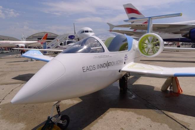

EADS had a pseudo model of an electric passenger aircraft at the Paris airshow. Apparently they like a hybrid approach: six electric motor driven ducted fans, a battery, and a single traditional jet turbine that assists on take off and generates electric power for the fans/battery.
I'm curious as to what would drive a practical upper limit to ceiling for such commercial e-aircraft? Wing stall? Passenger compartment pressurization?

Also appears the above-wing mounted fans allow a return to fuselage quite a bit lower to the ground on take off and landing, avoiding these kinds of ground standoffs driven by current jet turbo fans.

Also on the subject of CG advances, on re-watching the EADS promo film, I notice that they fairly clearly call out the e-motor fans as producing the thrust, I think they mean all the thrust, and that the single large combustion turbine is only for generating electrical power and no thrust.
Some reasons that come to mind for forgoing thrust on the turbine:
1. CG. A center mounted jet turbine for thrust pretty much has to be an absolute rear mounted turbine. In the notional promo, they show the turbine mounted perhaps 10-15% forward of the stern along the roll axis.
2. Full thrust power is available at high ceiling (any elevation) when on batteries alone.
I think the turbine in this EADS configuration utilizes all shaft HP as a means to charge the batteries and to provide more electrical power to the motors when needed such as during takeoff.
Pilot checks CG on the ground with cockpit instrumentation and the autopilot will take care of that in the air on cruise.
Eads' concept gets power from the gas turbine and transmits it electrically to the fans. Batteries serve for short thrust increase at take-off, and to store regenerative "braking" (descent).
Its ceiling is hence the same as other jets, resulting from the gas turbine and the wing.
Getting the thrust mainly from electric fans is a means to increase the blown area and distribute the thrust. This improves the efficiency, as a step beyond by-passing.

Yes, on review I see that is the current EADs concept - battery is never the sole energy source for the e-fans, so the ceiling has the same limitations. I'm curious as to what multiple of battery capacity would be required to also support cruise per unit range, at a higher ceiling w/ lower drag.
