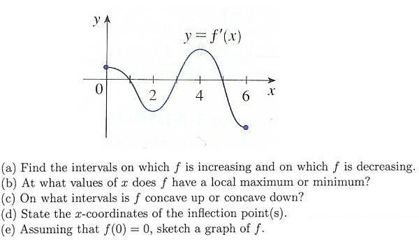

Hello,
I have this problem that I completed. I was hoping somebody could just let me know, based on my answers if the graph I have drawn looks to be correct? I would really appreciate it.
Thanks to anyone who replies. :smile:
