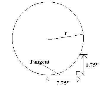

I'm trying to figure out the radius of a circle that intersects two points on a right triangle. One side of the triangle is tangent to the circle and the other intersects it. I have attached an image that helps further explain what I'm talking about. Knowing what I have listed in the image is there anyway to determine the radius of that circle?

If you think about it in terms of coordinates and represent the circle by the equation x^2+y^2=r^2, then then tangent vertex on your triangle is (0,-r), right so far? What are the coordinates of the other vertex on the circle? It must also have a distance from the center of the circle at (0,0) of r, yes? That should give you an equation to solve for r.
You could also go about solving this without using coordinate geometry.
Draw a hypotenuse for that right angled triangle, which will have a length of [tex]\sqrt{x^2+y^2}[/tex] and then draw two radii connecting to each end of the triangle, ofcourse these will both have length r since they're radii.
Now label the angle between the two radii as [itex]\theta[/itex], do you know what the length of [tex]\sqrt{x^2+y^2}[/tex] is in terms of r and [itex]\theta[/itex]?
Once you find that out, you'll have an equation in terms of r and [itex]\theta[/itex], and since we don't know the second variable, we'll need to find one more equation. Consider the properties of the side of the triangle that is tangent to the circle.

name the vertex as shown in the picture below.
Join AC.
In right triangle ABC,
[tex]\sqrt{(1.75cm)^2 + (7.75cm)^2}[/tex] = 7.95cm
Now draw a perpendicular OD to AC.
Since perpendicular drawn from the centre of a circle to a chord bisects the chord. Therefore AD=CD=3.975cm.
In triangle ABC,
tan [tex]\theta[/tex] = 1.75/7.75
tan [tex]\theta[/tex] = 0.225
[tex]\theta[/tex] = tan-1 0.225
[tex]\theta[/tex] = 12.68 degrees
Now join OC.
Since BC is a tangent, therefore Angle OCD = 90 - 12.68 = 77.32 degrees
in triangle OCD,
cos 77.32 degrees = 3.975/OC
0.22 = 3.975cm/OC
OC = 18.07 cm
Since OC = radius of circle
Therefore radius of circle = 18.07 cm
(Please someone correct it if it is wrong).

And the final formula is [tex]\frac{\sqrt{x^2+y^2}}{2tan^{-1}\left(\frac{y}{x}\right)}[/tex]
where [tex]x<y<r[/tex]
And plugging in those values given, I get 17.89 rounded off. Your answer is probably slightly off due to your intermediate rounding.

Thank you. All of this was very helpful.
