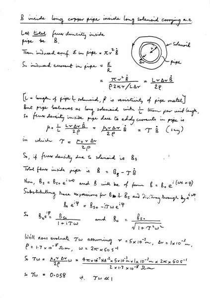

Divide up rod (length L, radius a) into co-axial 'pipes'.
Flux through pipe of radius r and wall thickness dr is [itex]\Phi[/itex] = [itex]\pi[/itex] r2 B.
emf is [itex]\epsilon[/itex] = [itex]\pi[/itex] r2 [itex]\dot{B}[/itex]
Current in annulus is Iann =[itex]\frac{\epsilon}{R}[/itex] = [itex]\frac{\pi r^{2}\dot{B}}{\rho 2\pi r/L dr}[/itex] = [itex]\frac{Lr dr \dot{B}}{2 \rho}[/itex]
Integrating between r = 0 and r = a, to find total current circulating in rod:
Iann = [itex]\frac{L a^{2}\dot{B}}{4 \rho}[/itex]
in which [itex]\dot{B} = \mu_{0}\frac{N}{L} I_{0} \omega cos (\omega t)[/itex]
N = number of turns in solenoid, I = peak solenoid current.
This neglects flux due to the induced currents in the rod.

It might not be too bad to work out flux due to eddy currents, as the rod is a system of nested long solenoids (assuming my original part-solution was valid). I'll have a go.
What I've done is to consider a hollow rod, i.e. a pipe, inside the solenoid, parallel to its axis. I'm fairly confident that by performing one or two integrations w.r.t. r, we could modify the treatment to give the eddy currents in the solid rod (assuming that they are circles around the rod axis).
Anyway, the case of the pipe is in the attachment. My conclusion is that for a copper pipe of diameter 1 cm and wall thickness 1 mm, the flux density inside it due to the induced current in its walls is small compared with the field due to the solenoid, assuming a frequency of 50 Hz. The frequency, though, is crucial. Around 1000 Hz, the eddy current contribution overtakes the solenoid contribution (if my calculations are correct).
Thanks for the calculations and the attachment.
Your calculation is based on a uniform field in the cylinder. Perhaps when the cylinder is made of a non-ferromagnetic material, the flux due to the induced current is small. However for an iron cylinder, which is usually the case for cores, the flux due to the induced current is quite large, so that it makes the flux in the cylinder non-uniform and causes the skin effect of the flux ( as well as the skin effect of the induced current).

Yes. I think I've pushed elementary methods to their limit (or beyond it!) with the case of the copper pipe! I'll be interested in what you find for the ferromagnetic cylinder.
