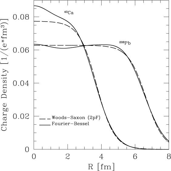

Describe the advantages of electron scattering over alpha particle scattering. Sketch a graph of charge density vs distance from centre of nucleus. From the graph, explain why protons are more influenced by strong force than coulomb force.
I've been looking around the net and can't seem to find a direct comparison between electron and alpha scattering. I understand that high energy electrons can penetrate the nucleus, I understand that alpa scattering gives closest approach... but where's the real advantage?
Can't seem to find charge density vs distance either
I understand that strong force works at 1fm, disappears at 2.5fm. What range was protons at again? Can't seem to find it.

hmm. The first question is what are they using the scattering for? To probe the nucleus? In this case, I guess that 'charge density vs distance from centre of nucleus' is talking about the density of the nucleons inside the nucleus.

I found out that nucleons are usually around 1.3fm. And the strong force is good from 0.5 to 2.5fm so that's why protons are influenced by strong and not EM.
Still can't find the graph though

Guessing charge density is 1/r^2 relationship?
Please comment and correct

Found the graph:
Thanks for the help.
