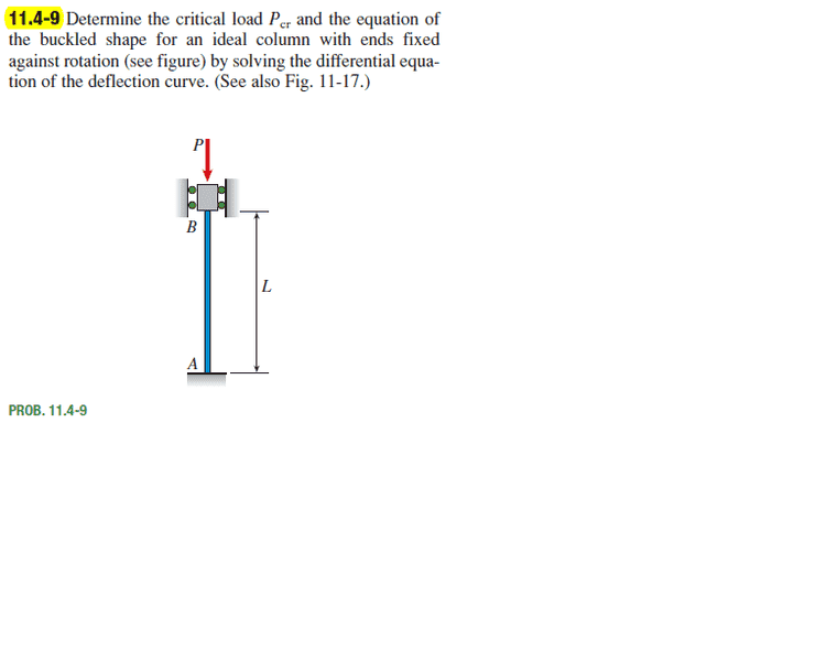

Hi,
I desperately need help to solve the following differential equation for buckling of a beam with a uniform axially applied force and a point force:
∂y(x)2/∂x2+(P+Q.x).y(x)=0
Where P and Q are constants. P is known and Q is the critical axial uniform force (N/mm) that will cause buckling.

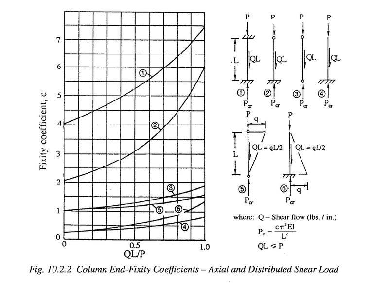

The trivial solution will always tend to C1=C2=0 for buckling, as C1 and C2 are irrelevant. It's always the terms inside the bracket that determine bthe critical buckling load. Only once I have an expression for y[x] can I manipulate the boundary conditions to obtain q.
I am trying to recreate the attached graph from Michael Niu, Airframe Stress Analysis and Sizing.
Thanks again,

Thanks for taking the time to understand the problem. Now you see why, when we add a distributed load q.x into the mix, it complicates things tremendously. I would love to solve the above problem with a q.x added, as well as for the clamped-clamped beam (attached). Then I would be able to solve for all boundary conditions.
If you add a q.x term into the LHS of the equation for the problem you just did above, what particular solution does Mathematica give for the term on the RHS?
Regards,
Most likely, that graph (and your other attachment) were made using numerical methods, not by trying to find analytic solutions of a differential equation. This is a trivial problem to model with finite element analysis.
Of course the numerical results will not be "perfectly accurate", but the simplifying assumptions made in this idealized math model of buckling could easily introduce "real world" errors of 50% or more. Getting a mathematically exact solution to the differential equation is not very important compared with that.
