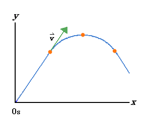

In summary, a physics student on Planet Exidor is trying to determine the velocity of a ball at t=0.00 s, given its position and velocity at t=1.00 s. The ball follows a parabolic trajectory and its position is shown at 1.00 s intervals until t=3.00 s. The velocity at t=1.00 s is given as v=(1.95i+2.32j) m/s and the student has been unable to make any progress using the kinematic equations, considering that acceleration due to gravity only affects the y direction. Any help or suggestions are appreciated.
mathewings
Below is the first in a series of questions that build on one another; however I cannot solve this initial one. Any help is appreciated.
A physics student on Planet Exidor throws a ball, and it follows the parabolic trajectory shown. The ball's position is shown at 1.00 s intervals until t=3.00 s. At t=1.00 s, the ball's velocity is v=(1.95i+2.32j) m/s. Determine the ball's velocity at t=0.00 s. (Enter your answer in component form. Input the x-component first, followed by the y-component.)
what have you done so far? any quess or attempts you have tried?
I've been thinking it over for some time. I can't get anywhere with it. I've done nothing.
look at your kinematic equations and remember acceleration due to gravity is only in the y direction.
