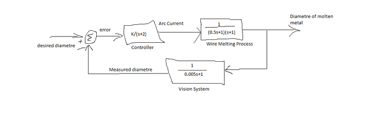

In summary, the task is to find the maximum value of K required to achieve stability for a welding robot defined by a block diagram. This involves reducing the blocks to a single transfer function and using the feedback formula to obtain the open-loop transfer function. The criterion for stability is that the gain of this function must be less than 1 when the phase shift reaches 180 degrees. This can be determined by plotting the magnitude and phase of the function and adjusting the value of K until the criteria is met. Alternatively, the root locus method can be used, which involves graphing the poles and zeros of the system and finding the values of K where the poles cross the imaginary axis. MATLAB can be used to easily plot the root locus and determine the stability
Fisher92
80
Welding robot is defined by the block diagram attached/ excuse the paint work.
(hope that worked)
find:
a)maximum value of K required to achieve stability.
b)roots of the characteristic equation, at half the maximum K value.
c)estimated percentage overshoot, if the complex roots determined
in part (b) are dominant and half the maximum K is considered.
NA
Pretty sure that the first step is reducing the three blocks to a single transfer function?
This is pretty simple, two top blocks are cascaded then using the feedback formula gives.
Gives:
[tex] \frac{K}{(0.5s+1)(s+1)(s+2)}[/tex]
Using the feedback formula gives:
[tex]\frac{\frac{K}{(0.5s+1)(s+1)(s+2)}}{1\pm\frac{K}{(0.5s+1)(s+1)(s+2)}* \frac{1}{0.005s+1}} [/tex]
a) Max value of K to achieve stability:
simplifying - getting tired of LaTex, so:http://www.wolframalpha.com/input/?i=%28k%2F%28%280.5s%2B1%29%28s%2B1%29%28s%2B2%29%29%29%2F%28PlusMinus%5B1%2C%28k%2F%28%280.5s%2B1%29%28s%2B1%29%28s%2B2%29%29%29*1%2F%280.005s%2B1%29%5D%29
There are poles and zeroes at s=0 - have to consult my textbook but I can't see how it can be simultaneously asymptotic and 0 ?? - zeroes at s = -1, -2....I'm a bit stuck here - Routh table?
Thanks, any help appreciated.

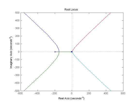

My open loop system equivalent is:
[tex]\frac{k}{(0.005s+1)(0.5s+1)(s+1)(s+2)} [/tex]
[tex]=\frac{k}{0.0025s^4+0.5125s^3+2.52s^2+4.01s+2} [/tex]
so to plot the root locus in matlab, just adjusting your syntax would be:
sys1 = tf(1, [0.0025, 0.5125, 2.52,4.01,2]) % open loop system
sys1c = feedback(0.1*sys1,1) % closed loop system with k = 0.1
figure(1)
rlocus(sys1c) % root locus
Tested this and it gives me the root locus:
But this is for K=1, how can I get the max value of K where the system is stable?

my lecturer put us on to these youtube videos, worth checking out
Starting to understand the root locus a bit. rude man would you mind explaining why the open loop transfer function is used instead of closed loop? can't seem to figure that out.
As I understand the root locus, the system is stable on the lhs of the jw axis. So the max gain (K) for stability is at that crossing - or the point that sits on the jw axis? How can I get MATLAB to tell me the value of K for this?
