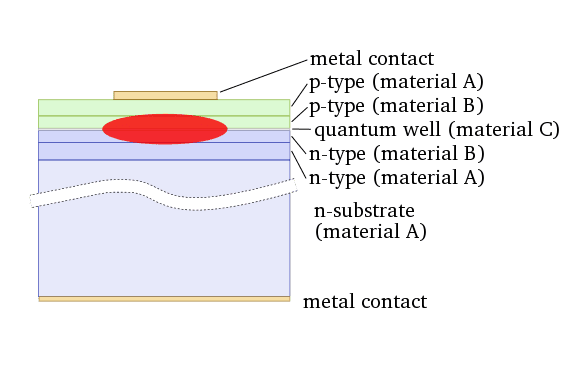

Quantum laser diodes.
How does light escape?
I recently became very interested on the functioning of these amazing devices and so I read online about the topic of quantum wells, semiconductors and lasers.
After much reading I believe I can now understand the basics of lasers, resonant chambers, semiconductors, band-gaps and quantum wells and how they produce light.
Only one point is missing in the puzzle:
After visible light has been created in the thin quantum well layer, how can it escape to the outside world?
How is the light not trapped immediately after it is created, by colliding with the quantum well material? How does it exit the thin quantum well layer? How does light move inside the diode, being it's semiconductor materials opaque? Shouldn't the opaque semiconductor stop and absorb the light like a normal opaque material?
I am aware there are various types of quantum laser diode design but in none I can comprehend: How the light created in the well travels from the quantum well through all the semiconductor material bounding the well to reach outside.
The typical materials used are aluminium gallium arsenide and gallium arsenide for the walls and Indium gallium arsenide for the quantum well.
Are these semiconductors used transparent? Or is a material's transparency not applicable to very small films? Or is there some other mechanism to evacuate light out of the device?
A simple quantum well laser diode:
Semiconductors are opaque for energies above their band gap and transparernt below. Typically quantum wells emit at an energy below the band gap of the bulk wetting layer material which means that the bulk material is transparent for the emission.
The low temperature band gap of bulk GaAs is around 1.42 eV. GaAs based VCSELs are infrared devices which means that the material is indeed transparent. Obviously GaAs-based devices are therefore not suitable for building lasers that emit in the visible regime. There you might rather use InP (visible red), ZnO (blue) or ZnSe (green).
manueldois said:
How does light penetrate through all the layers?
Which layer are you interested in? The quantum well layer is tiny, so the interaction probability is not too large anyway. In addition, you want the quantum well population to be inverted, so upon interaction with light the predominant interaction occurring will not be absorption, but stimulated emission. Light obviously does not transmit well through the DBR structures. They typically have a reflectivity on the order of 99.9999%. This huge reflectivity is needed to achieve lasing as the size of the active medium (the quantum well) is quite tiny. The small part which is not reflected gives the VCSEL emission. Typically VCSELs are grown with asymmetric DBR structures, so that the emission is preferentially leaving the VCSEL at one end.

Just the first sentence cleared most of my confusion!
I saw a couple of photos of semiconductors on Wikipedia in powder form, only now I give special attention to search for a whole crystal are the ones used to make LED's and laser's are indeed transparent.
Noticed there are many promising materials still waiting in line to photonics research. We'll have a very well lit future.
