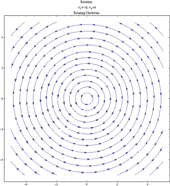

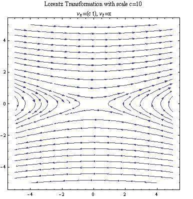

It has something to do with the difference between the trigonometric functions and the hyperbolic trig functions.
Solutions of dy/dx=-x/y lead to x^2 + y^2 = Constant. These are circles.
Solutions of dx/dt = t/x lead to t^2 - x^2 = Constant. These are hyperbolas.
One big difference is that if you have something in front of you, you can turn around and make it to your left, then behind you, then to your right, then in front of you again. It all forms one continuos circle.
On the other hand, you can't take an event that's in your future, and and turn until it is to your left, then in your past, then to your right, then in your future again. They are four separate hyperbolas.

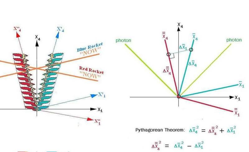

The diagram at the left represents a guy in a red rocket moving to the left (with respect to the black rest system) at relativistic speed and another blue guy moving to the right with the same speed. Special relativity tells us that the two will experience different cross-section views of the 4-dimensional universe. Accordingly, when the red guy is at station 9 along his X4 world line his 3-D cross-section view of the 4D universe shows the blue guy to be at station 8. But, when the blue guy is at station 9 his 3-D cross-section view of the 4D universe shows the red guy to be at station 8. Each sees the other guys clock running slow.
Now, using the triangular relation diagrammed on the right, you can derive the metric beginning with the actual Pythagorean Theorem as your intuition seems to prefer. We simply recognize distances layed out in the 4-dimensional space. Look at the right triangle formed by the X4 coordinate of the red guy's system and the X1 and X4 coordinates of the blue guy's system. Just write down the Pythagorean equation directly for the hypotenuse and sides of the triangle. The blue X4 coordinate is the hypotenuse in our example. But, you can now solve the equation for just the red guy's X4 coordinate if you wish. And this is the form for the metric. Nevertheless, the Pythagorean Theorem still works for the spatial distances manifest in the diagram.

Another way of looking at it is that when you are talking [itex](x,y)[/itex] coordinate distance, you can imagine concentric circles around either particle and ask, what concentric circle the other particle is on. The answer involves a [itex]r=\sqrt{x^2 + y^2}[/itex]
With [itex](x,t)[/itex] event distances, you can imagine "concentric" hyperbolas around one of the events and ask which hyperbola the other event is on. The answer involves a [itex]\tau = \sqrt{t^2-x^2}[/itex] or [itex]s=\sqrt{x^2-t^2}[/itex] (depending on which quadrant you're in.)

For visualization purposes, imagine what this diagram would look like if c were set to 300 million meters per second (by setting the vertical scale to seconds, and the horizontal scale to meters), instead of c=10
The hyperbolas on the top and bottom would flatten into horizontal lines, and the ones on either side would disappear altogether. The lines would mark off t≈τ=-1, t≈τ=0, t≈τ=1, t≈τ=2, etc.
