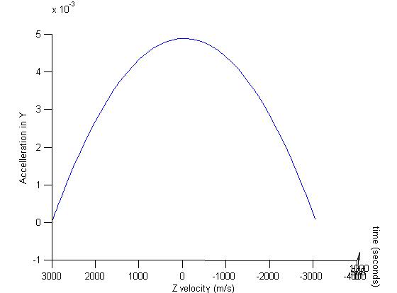

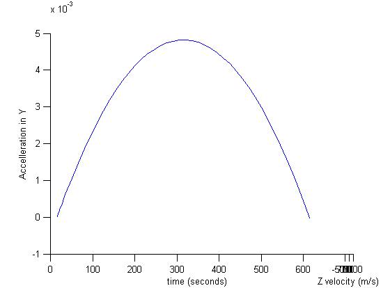

I'm using MATLAB show the path of a projectile fired directly up(directly out from the center of the earth) from 41 degrees north latitude. Air resistance, variation of gravity cause by height, and the centrifugal force are for now ignored. What I'm trying to figure out is why there is a north deflection of the projectile. That is why does the object land north of where it was fired while there was no initial north/south velocity or displacement.
I've ruled out gravity because it will only act in the up/down direction (until the object is deflected north/south then it will have some impact). I'm thinking that it has to do with the up/northward direction of the angular velocity of the earth. It is perfectly parallel with the Earth's axis of rotation. Here are my plots.
Any thoughts?

I have modeled the Earth's rotation consistent with 2pi/1 day. The projectile reaches a height of about 4.5 x 10^5 meters. I haven't tried changing the direction of the rotation of the earth, as I'd rather not find all of my differential equations again. However I have found that when the z(up/down) velocity is positive, the projectile accelerates away from the equator and towards the pole. While if the z velocity is negative the projectile accelerates towards the equator. The acceleration in y(north/south) is directly relation in a parabolic curve to the velocity of z. Sometime this weekend I will add the forces neglected, air resistance, variation of gravity and the centrifugal force.
I'm using a typical MATLAB ode solver, file with solver and plot statements has been left out.
Here are my differential equations:
function d_dt = rocketball(t,r)
global w lambda g
d_dt = zeros(4,1);
d_dt(1)= r(2)
d_dt(2)= 2.*(r(4).*w.*sin(lambda)-r(6).*w.*cos(lambda))
d_dt(3)= r(4)
d_dt(4)= -2.*r(2).*w.*sin(lambda)
d_dt(5)= r(6)
d_dt(6)= -g+2.*r(2).*w.*cos(lambda)
where r(1) = x position, d_dt(1) = dx/dt
r(2) = x velocity, d_dt(2) = dVx/dt
r(3) = y position, d_dt(3) = dy/dt
r(4) = y velocity, d_dt(4) = dVy/dt
r(5) = z position, d_dt(5) = dz/dt
r(6) = z velocity, d_dt(6) = dVz/dt
lambda = 42 degrees north latitude, g = 9.81 m/s^2, w = angular velocity = 2pi/1 day
Some interesting plots...
thanks.
"However I have found that when the z(up/down) velocity is positive, the projectile accelerates away from the equator and towards the pole. While if the z velocity is negative the projectile accelerates towards the equator."
This statement is true in either hemisphere.
OK, I want to confirm that your vector multiplication for the acceleration was:
[tex]\ddot{\mathbf{r}} = - \dot{\mathbf{r}} \times \mathbf{\omega}[/tex]
In which case only your [itex]a_y[/itex] has the correct sign. I was curious as to why you put a factor of 2 in front of these??
Also, there is no need for you to model centrifugal force (you already have by your choice of co-ordinate system). Centrifugal force is a ficticious force that exists due to a frame of refrence that has angular momentum, you are "watching" the Earth rotating so you don't need to model this. To explain a little better, if there was was no gravity, your ball would just continue its path in the x direction. From the frame of reference of the Earth surface, this would be observed as some unknown force making the ball fly off into the sky (this force would be the centrifugal force)... I hope that explanation was adequate :P
I believe it is this force that is causing your object to fly North (however, if you put the vector multiplication the correct way round it would end up South). This is inline with the apparent gravity experienced by objects on rotating masses.

I suppose by deflection I mean any movement in the x-y plane where the initial velocity is in the z direction.
