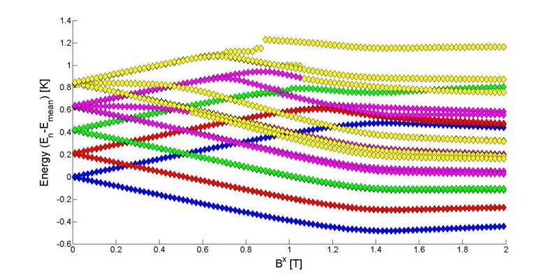

Perhaps the graphic results would illustrate my problem better.
The figure shows the energy levels as a function of applied field. let's say I start at the top blue level at zero field. If I ramp up the field very rapidly, I will stay at the blue level when I go past the red level at Bx=0.2T for example (the diabatic states are coupled and if you looked at a higher resolution you could theoretically see an avoided crossing).
However I do not know where will I end up when I get to Bx=2T. The blue level? a red one? or a purple one?
I've tried taking the dot product of the initial state (Bx=0) with the various states at a large field value (say Bx=2T) and looking for the largest product. This should be similar to what DrDu suggested if I'm not mistaken.
This gave the correct results for the crossings at low field values, but wrong results at higher field values. This is because the diabatic states themselves change with field.
A better method is to compare the eigenstate just before each crossing (lower field) to the eigenstate just after. However the question arises as to where does a crossing start and how to recognize it.
I've thought of a very lengthy solution (which I'm still working on) but I'm sure this kind of thing was tackled many times before. I have a feeling if I could name the problem properly, I'll find a well known algorithm for this.
Has anyone heard of something like this?

If the field changes at infinite speed, the sudden approximation becomes exact. On the other hand at very slow changes of the field, the states will follow the adiabatic surfaces.
Inbetween you have to solve in principle the total time dependent Schroedinger equation. This should not be too demanding in your problem. There are approximate formulas like the Landau-Zener formula.
Maybe the book: Molecular Collision Theory by M. S. Child is helpful as he discusses all known approximation schemes at length, especially Chapter 8.
What's the exact problem you are looking at?

What is this saturation due too, which occurs at field strength > 1.4, say?
I still haven't verified it, but it should be due to the states ceasing to have a clear up or down character for each ion. Instead ions should have an up+-down character at these high fields
