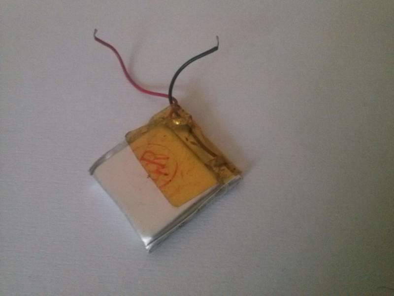

i got this small rechargeable battery that is from an mp3 player.. i would like to charge it up and use for other purposes, but the problem is that there is no specifications written on it.. i measured the voltage across and i found 4.7 V. how do i determine it's voltage, i don't know how long the battery has got discharged, because i want to make a circuit to charge it up..
Or if you know a circuit which could charge this up without damaging it would be very helpful..

I would guess that it is four cells of NiCd. Each is 1.2 volts which makes 4.8V total.
It could probably be charged from a 5 volt regulated supply.

I would imagine that you can get hold of a suitable charger for that particular mp3 player. You should be careful if you try your own charging circuit because it is easy to charge at too fast a rate or to overcharge and that can cause the battery to explode. Nasty - be careful.
If you use an 18 hour charger, there should never be any problems.
The attached photo looks to me as a Li-Po; is that all aluminum around the pack? If so almost definitely Li-Po. If it looks like only one item, then it is a single cell, max voltage after charge should be 4.205 volts. If it has a higher charge, it has probably been damaged. Please KNOW before you try to charge without the proper charger as Li-xx can cause a fire unless properly charged.

it's aluminum around the pack
Then almost certainly Li-Po. If it is reading 4.7, then it is probably already damaged and if it holds a charge will not preform anywhere near its original ratings.
Li-Po charging is complex compared to NimH or NiCd; Li-Po ideally requires constant current until a cell reaches 4.205 volts,then a constant 4.205 volts until the current drops to some small threshold determined by the rated current output of the pack or cell. Since this is from an MP3 player, its threshold is probably around 10 - 20 mA.
So if you have a lab power supply with max voltage and current controls, you can charge from there. Otherwise get a pre-built charger.
