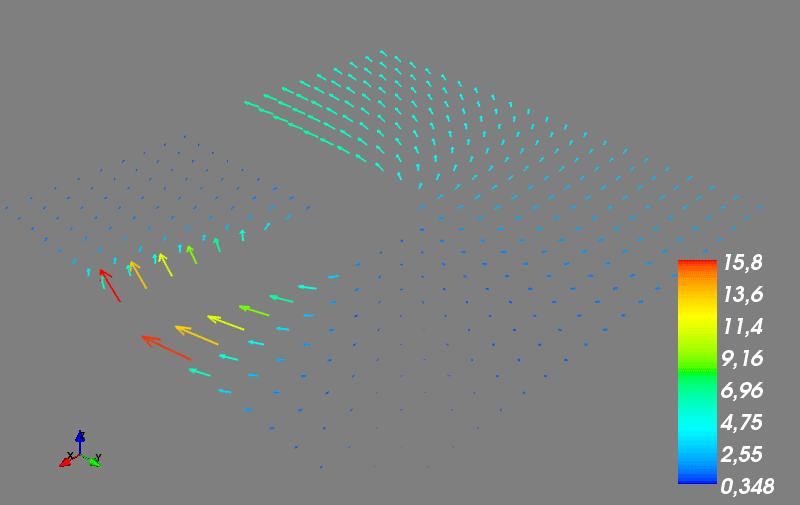

The gradient of this expression does not show a similar behavior like the initial vector potential, which suggests that this is no true solution to the equation.

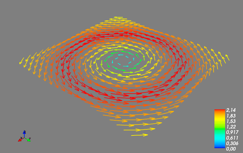

This is a cut plane throught the original vector potential.

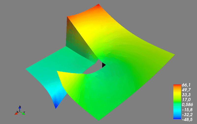

This is [itex]\Lambda[/itex] in the z=0 plane.

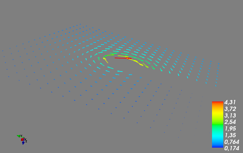

This is the gradient of [itex]\Lambda[/itex], which shows clearly a different behavior.
Using another approach
[tex]
\Lambda(r,\,\theta,\,z)=\left\{\begin{array}{cc}
\frac{1}{2}\theta^2+\pi\theta & r>r_0\\
? & r<r_0
\end{array}\right.
[/tex]
This results in a similar behavior for [itex]r>r_0[/itex]. In the following figure [itex]\vec{\nabla}\Lambda[/itex] is plotted for the entire range of r.
Looking that the solution you gave, I don't think you've got the correct solution as you have a singularity at [itex]\theta =0,-\pi[/itex] and when you set [itex]r=r_{0}[/itex] you don't get the same solution.
Also looking at your initial equations, [itex]A_{\theta}[/itex] appears to be constant for [itex]r<r_{0}[/itex] and yet in your later equations it isn't. I don't think that you've solved the equations correctly.
You cannot get rid of the vector potential with your gauge transformation because A has non-vanishing rotation. The problem has been solved in 1928 by Fock. Solutions of the radial part are associated Laguerre polynomials. See S. Mikhailov, Physica B 299 (2001), 6-31
