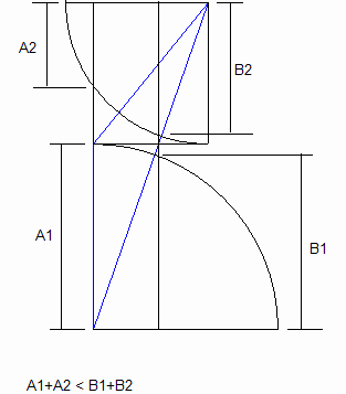

In terms of STR parlance, the distance between E and B is a proper distance vt where t is the time measured by the E and B clocks during transient. And the temporal distance measured in the EB frame is ct (a proper time.) These two factors determine Gamma and the time dilation. We can't say that clocks run slower or faster - age difference is simply a result of a particular experiment - in the case of the one way trip it is due to the invariance of the interval - the combination of the space distance and temporal distance in EB frame must total the temporal distance and space distance in the A frame

The drawing shows A and B both accelerating, they both are effected by time dilation to equal degrees, so your argument is not correct.
On the basis that “The drawing shows A and B both accelerating” it follows that ‘the drawing’ does not comply with Einstein’s chapter 4 depiction wherein he pointed out that it is clock A - and clock A alone - that is made to move not clock B and it is his comments to which my arguments apply NOT ‘the drawing’.
Einstein does not suggest that A and B are both made to move and in the twin paradox it is only the traveler who experiences a force of acceleration not the Earth so your comment that my argument is not correct, based on ‘the [inapplicable] drawing’ has no validity.
Why don’t you at least try to stick to the subject on hand rather than introduce red herrings in an attempt to obfuscate same using inappropriate materiel?
Picasso provided a drawing of a clock that was severely distorted thus could not possibly tick over let alone incur time dilation however I see no reason whatsoever for accepting the reality of his depiction.

Here is a geometrical explanation for the twin aging problem.
Time is not altered by motion, only the rate of activity and thus time measurement. When the twins separate and later rejoin, the same amount of time has elapsed for the universe, but the two clocks have sliced that time interval into different lengths.
The vertical line representing the height of the triangle, is the time for an object not moving, i.e., the minimum interval. Any motion to the right or left results in a longer/dilated interval. Divide the paths at the change of direction for A. For each segment, rotate the minimum interval to horizontal. Where the paths cross the horizontal,draw a vertical
line. Where the vertical intersects the arc, represents the amount of time for each twin for that part of the trip. The one who travels the greatest distance in a given time, will travel the fastest, and thus have more time dilation.

  • #67
phyti said:
Hey cos;
I'm a salmon guy, not herring.
Regardless of personal taste - there's something fishy.
Thank for your presentation however I am not looking for an explanation of same but am seeking comments in relation to the claim that from the astronaut's point of view, his clock does not tick over at a slower rate than it did before he started moving but that the Earth clock physically ticked over at a faster rate than it did prior to his starting to move.
When the twins separate and later rejoin, the same amount of time has elapsed for the universe...
In accordance with the above claim, it is (from that astronaut's point of view) not only the Earth-bound twin that ages at a faster rate than the astronaut but also the entire universe.

  • #70
cos;
The dilation only applies to the ship and its contents, thus the pilot cannot
detect the difference within his frame. If he looks out, he should see a
polarized universe, events forward happening faster and events rearward
happening slower, a scenario which is not normal.
It should be obvious from studying the light clock, the rate can only
physically decrease. Observers will perceive the others clock rate increase
when converging, and decrease when diverging, but these are doppler effects.
for the universe...
This is true if you change 'faster' to 'slower', where 'slower' is 'measured
as slower'. All other clocks do not change rates, because the astronaut initiated the
motion, and the amount of energy used to move the ship would not move the rest
of the universe in the opposite direction, i.e., the situation is not symmetrical by reason of the conservation of energy.
The ship moving cannot alter the rules of physics in distant parts of the
universe, especially instantaneously. That's the nonsense!
It violates postulate (1) that the theory is built on.
And then there's this:
SR theory transforms coordinates not objects.
Would you please pass the cucumbers.
