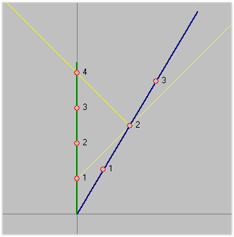

Time dilation and length contraction are well known. A third phenomenon, much more important but less cool-sounding, is the relativity of simultaneity. This resolves the problem. When the moving clock turns round it changes synchronisation convention, and the change in synchronisation exactly accounts for the "extra" time that the stationary clock shows compared to a naive time-dilation analysis done by the moving clock.
The simplest way to see this is to use the Lorentz transforms to work out what time the outbound frame says clock A will show at turnaround and what time the inbound frame will say it shows. The difference is the "extra" time you need.
So, the moving observer always watches the clock at point A. If he moves away from point A, in his view the clock at point A goes slower. If he moves to point A, the clock at point A goes faster. If he reaches point A, the clock will go renewed slower than his own clock.

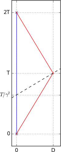

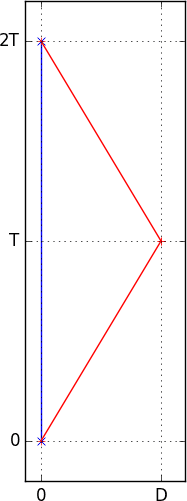

What Einstein wrote, essentially:
"Consider a system of coordinates in which the laws of Newtonian mechanics hold good ... we assume (as a postulate) that the speed of light is independent of the source ... we show that time dilation applies to a clock moving in this system of coordinates".
How @worlov interpreted this:
"Consider any system of coordinates (whether Newton's laws apply or not) ... assume time dilation and the Lorentz Transformation apply with this coordinate system ... state that any observer can consider himself at rest and consider himself an inertial observer - reach a contradiction."
You are ignoring the critical criterion of Einstein's paper that his result apply to observations made in an inertial reference frame. Not in any reference frame.
Movement in a circle has no effect on the formula for time dilation for an inertial obsever, observing the object in circular motion. But, the object in circular motion is not an inertial observer and cannot apply the time dilation formula to objects moving in his system of coordiates.
That is, incidentally, the same in Newtonian mechanics. For example, if you are an inertial observer and an object is moving in a circle, you can conclude and calculate that the object is subject to a centripetal force. However, for the object moving in a circle, it sees you moving in a circle, but if it concludes that you must be subject to a force, then it is wrong. There is no force on you. Your circular motion is due to its acceleration, not your own.
Or, think of someone jumping up and down on a trampoline. You can study the trampolinist's motion using Netwon's laws (or SR if your prefer). But, the person on the trampoline cannot directly use Newton's laws (or SR) to explain why the rest of the world is bouncing up and down!
If you do not accept this, then you can go ahead and find contradictions all over physics. No physics will hold together if you take results derived in inertial reference frames and apply them in non-inertial reference frames. Time dilation is one example. Newton's laws of motion are another example.
You must understand the difference between observing accelerated motion (from an inertial reference frame) and an observer in a state of acceleration trying to use the laws of physics that do not apply in an accelerated coordinate system.

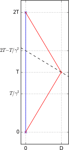

Check out the link I posted, where as others have mentioned, the relativity of simultaneity is critical to the calculations.
worlov said:
Well, Einstein ignored the acceleration phases
But not the relativity of simultaneity. Which is the source of the "extra time" I've been banging on about since #2. You can either treat the polygonal lines using inertial frames and correct for the relativity of simultaneity at the corners, or regard the whole thing as a non-inertial frame. Either way, simply applying the inertial frame time dilation formula isn't correct for describing the inertial clock from the traveller's point of view.

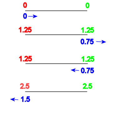

Let's try to clarify just what is meant by how the Relativity of Simultaneity is critical.
You have three clocks, Red, Green, and Blue.
Red and Green remain at rest with respect to each other, and it their rest frame are synchronized. Blue travels from Red to Green and then back to Red.
Thus according to the Rest frame of Red and Green the sequence of events unfolds like this assuming that blue has a relative velocity of 0.8c, the distance between Red and Green is 1 light hour, as measured in the rest frame of Red and Green.
Blue leaves Red while All three clocks read zero.
Blue arrives at green when both Red and Green reads 1.25 hr, and it reads 0.75 hr due to time dilation.
Blue reverses direction. All the clock readings remain the same.
Blue arrives back at Red, reading 1.5 hrs, while Red and Green read 2.5 hrs.
Now the same events according to Blue.
Blue is at rest while Red and Green are moving. Since Red and Green are moving, they and the distance between them is length contracted to 0.6 light hr. Red and Blue still both read zero when they start off next to each other. However, due to the Relativity of Simultaneity, Green already reads 0.8 hr
It takes 0.75 hr for Green to reach Blue (0.6 light hr/ 0.8 c) During which time both Red and Green run 0.6 as fast as Blue and advance by 0.45 hr. Green now reads 1.25 and Blue reads 0.75, just like when we looked at things from Red and Green's frame. Red however only reads 0.45 hr. (0.8 hr behind Green)
Red and Green reverse direction. The reading on Red and Green do not change, But now that the relative velocity of Red and Green with respect to Blue have changed, Relativity of Simultaneity requires that Red is the clock that is ahead of Green by 0.8 hr. Thus now Red read 2.05 hr.
Again, it take 0.75 for Red to reach Blue, during which time both Red and Green advance 0.45 hr. Upon rejoining, Blue reads 1.5 hr and Red reads 2.5 hr. In perfect agreement with the end result when we assumed that Red and Green were at rest the whole time.
Red and Blue are in perfect agreement as to the start and end of the scenario in terms of what each of them reads, but they disagree as to what happened between start and finish.

Here are some spacetime diagrams to explain why the time dilation formulae don't work here, and why the relativity of simultaneity is important. I've done this for a simple out-and-back twin paradox with instantaneous turnaround and a constant velocity of 0.6c. The extension to more complicated cases is messy, but fundamentally the same.
First, here's a spacetime diagram of the stay-at-home clock (blue worldline) and the traveling clock (red worldline) in the frame of the stay-at-home:
The turnaround happens at time ##T##. But now let's think about the outbound frame, the frame in which the traveling clock is at rest as it travels to the right. The turnaround happens at time ##T'=T/\gamma## in this frame. But the Lorentz transforms tell us that ##T'=\gamma(t-vx/c^2)##, which is to say that "at the same time as the turnaround according to the outbound frame" is a sloped line on this graph, satisfying ##t=T'/\gamma+vx/c^2=T/\gamma^2+vx/c^2##. That's the dashed line in the diagram below:
The dashed line intercepts the stay-at-home clock's (blue) worldline at ##t=T/\gamma^2##. This is exactly consistent with time dilation - the traveling clock experiences ##T/\gamma## of elapsed time, and measures ##1/\gamma## less time on the stay-at-home clock.
Now let's turn our attention to the inbound frame. The maths here is a bit messier. The turnaround in this frame happens at ##T''=\gamma(1+v^2/c^2)T##. Again, the Lorentz transforms tell us that ##T''=\gamma(t+vx/c^2)##, or ##t=(2T-T/\gamma^2)-vx/c^2##. Again, this is a sloped line, but it is not the same sloped line as above - it slopes in the opposite direction.
Again, this is consistent with the time dilation formula. The traveling clock experiences time ##T/\gamma## on the inbound leg, and measures the stay-at-home clock to experience less time by another factor of ##1/\gamma##.
But now we can see what's gone wrong. The time up to ##T/\gamma^2## on the stay-at-home clock is "during the outbound leg" according to the outbound frame, and the time after ##2T-T/\gamma^2## is "during the inbound leg" according to the inbound frame. But because we changed our definition of "at the same time as the turnaround", to naively apply the time dilation formula is to forget about the middle portion of the worldline. This is why there is no problem with the behaviour of the stay-at-home clock - it ticks 2T times. But if you don't account for the relativity of simultaneity you have forgotten about ##2Tv^2/c^2## of them.
