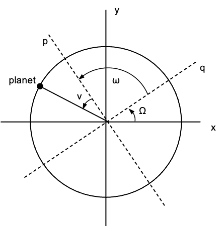

It is easier to see what's going on if you first look at the situation when the inclination ##i## is zero and then rotate the plane of the orbit away from the ecliptic. This is shown in the figure below. We have auxiliary axes ##p## from the sun to the perihelion and ##q## perpendicular to ##p##. The heliocentric axes are ##x## and ##y##.
We write unit vector relations
$$\begin{align} & \mathbf{\hat q}=\cos\Omega~\mathbf{\hat x}+\sin\Omega~\mathbf{\hat y}\\ & \mathbf{\hat p}=-\sin\Omega~\mathbf{\hat x}+\cos\Omega~\mathbf{\hat y}\end{align}$$The position of the planet is $$\begin{align} \mathbf{r}=r\cos(\omega+v)~\mathbf{\hat q}+r\sin(\omega+v)~\mathbf{\hat p}.\end{align}$$We now consider how these vectors change when the plane of the planet's orbit is rotated away from the ecliptic about the ##q##-axis to inclination angle ##i##. Only unit vecor ##\mathbf{p}## will change form. It will be off the plane of the ecliptic. Noting that its projection on the ecliptic is along its old direction. We have$$\begin{align}\mathbf{\hat p'}=\cos i (-\sin\Omega~\mathbf{\hat x}+\cos\Omega~\mathbf{\hat y})+\sin i~\mathbf{\hat z}.\end{align}$$We obtain the position of the planet in heliocentric coordinates in the inclined plane using equation (3) in which ##\mathbf{\hat p}## is replaced with ##\mathbf{\hat p'}## from equation (4) and ##\mathbf{\hat q}## from equation (1). We get $$ \mathbf{r}=r\cos(\omega+v)~( \cos\Omega~\mathbf{\hat x}+\sin\Omega~\mathbf{\hat y} )+r\sin(\omega+v)~cos i [(-\sin\Omega~\mathbf{\hat x}+\cos\Omega~\mathbf{\hat y})+\sin i~\mathbf{\hat z}]$$Separation of the cartesian components provides the desired relations.
