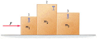

As shown in Figure 5-22, a force of magnitude 7.50 N pushes three boxes with masses m1 = 1.30 kg, m2 = 3.30 kg, and m3 = 5.10 kg.
(a) Find the magnitude of the contact force between boxes 1 and 2.
(b) Find the magnitude of the contact force between boxes 2 and 3.
So F=7.5N. First you need to find the acceleration right? So I got a=F/m and did 7.5/(1.3+3.3) for part a. That gave me 1.63. I multiplied that with 3.3 because that's the mass of the second box and got a contact force of 5.379N but it's telling me that it's not right. If anyone could help I'd really appreciate it

What happened to the third mass?
I'm confused about how I work that in there...I was kind of doing the problem as if the third one wasn't there which is wrong. So I do 7.5/(1.3+3.3+5.1) to get a? And then once I have a how do I find the contact force?
You apply Newton's 2nd law: First to the entire 3-block system, to find a. Then to each mass separately, to find the contact forces. (Realize that the F in F = ma is the net force.)
Ahh, I figured it out, thanks
