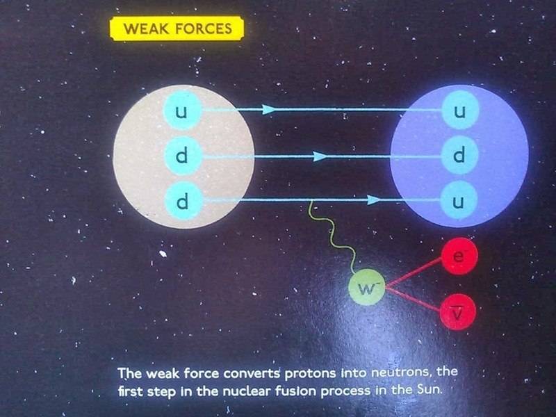

Hi. I need help please with a textbook illustration that has confused me.
Is the caption a typo? Should be "neutrons into protons" instead?
Thanks.

The illustration is correct. A helium-2 nucleus, aka a diproton, is not stable, so when two protons collide in the core of the Sun, one of them MUST be turned into a neutron in order for proton-proton fusion to work. Most collisions between protons do not result in fusion. It is only on the very rare occasions that the weak force is able to turn one of the protons into a neutron that fusion occurs.
See here: http://en.wikipedia.org/wiki/Proton-proton_chain_reaction

Thank you for your help. I understand now that it's protons to neutrons.
My confusion stemmed from the placement of the quarks. Is the proton on the left incorrectly labeled with two down quarks and one up quark--should have two up and one down? Vice versa for the neutron on the right?

bluejello said:
My confusion stemmed from the placement of the quarks. Is the proton on the left incorrectly labeled with two down quarks and one up quark--should have two up and one down? Vice versa for the neutron on the right?.
Yep, you're right. The picture has it backwards!
Oh wow, I didn't even notice, lol.
Oh good, I felt stumped. Nice relief.
Thank you, both!
