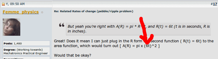

Great! Does it mean I can just plug in the R form the second function ( R(t) = 6t) to the area function, which would turn out [ A(R) = pi x (6t)^2 ]
Would that be okay?
Yes, you can do that. Albeit it's slightly unnecessary since the picture reveals that radius is 12 when time is 2. Mathematically, it's correct though.
Now derive both sides, with respect to time, solve for t = 2, and you have your answer.

Oh, can I just do...
http://img204.imageshack.us/img204/2202/dadtf.jpg
Hmm but I end up with the same answer
No, you cannot. It is purely coincidental. We will only arrive at the same answer when t = 2. What if they asked for area behavior when t = 3? Our formulas yield the same answer because I am multiplying 2, 6, and 12, while you are squaring 12. (12)(x) = x^2 ONLY when x is 12.
Not to get too analytical, but look at it this way, your equation shows area increasing at a rate of [itex]\pi r^2[/itex]. That IS area. If your rate of area change equals the area formula, that would mean your area was doubling every second. A circle can't double in area every second when the radius is increasing at a constant speed! Does that make sense?
The reason why we got the same answer when t = 2, is because area in fact is doubling when t = 2, but ONLY when t = 2.
Then I just do
3 x 6 = 18
2 x pi x 18 = answer

That doesn't work.
Would that be okay?
Yes. If you do this, you'll get the answer!
Sorry, but you need to differentiate before plugging in the numbers.

According to the chain rule you need to calculate:
A'(R(2)) . R'(2)
As an alternative you can use what you already wrote:
A(R) = pi x (6t)^2
Take the derivative with respect to t.
And (after taking the derivative) fill in t=2.
Both ways should give you the same answer.
  • #33
You forgot to take care of the round thingies.
  • #34
Your mistake is that you said [itex](6t)^{2}=36t^{2}[/itex] and you also want:
[tex]
\frac{dA}{dt}=\frac{dA}{dr}\frac{dr}{dt}
[/tex]
  • #35
Femme_Physics, what you need to understand is that we are finding the rate of change of area by observing the relationship between area and radius, because we know the rate of change of radius.
I don't see any inclusion of the rate of change of radius in your work.
